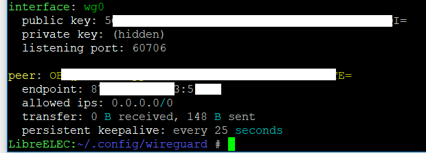

    when i use connmanctl connect vpn_<my selected name> it goes UP and on OpenWRT Wireguard Status i see some Tx and RX bytes but Last Handshakes reports "never"...
    this is what on OpenWRT

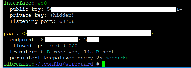

    this is my LibreELEC...
    i'm sure.. keys are corrects .. possible are they wrong ?
    Wireguard server on OpenWRT works correctly... i've tested using the same source connection (other modem) ... using my android phone in wifi connected works.. using LibreELEC Kodi wired connection it does'n work.. :(

  • Last update...
    i tried with the same Keys of Android device, using same IP too... and the result is always the same ;(
    no handshake....
    i'm thinking about something missing or wrong in my LibreEL PI 2 B ...
    is there something i can check or verify on LE configurations ? ... sw ? config ? network ? ... iptables are disabled...
    or maybe something on openWRT ? ... something that works with Android and not with LE...
    i really don't know what to look for... ?(
    thaks for your patience..
  • hey.... effectively that configuration is correct :) ;) :thumbup:
    the problem i using myDynDNS in LE wireguard .config file... using <myDynDNS> registered in dyndns.it handshake doesn't works, but if i use the really IP address, handshake is correct and VPN goes UP ...
    i tried using both configurations in LE .. DHCP and StaticIP with google DNS.. but is the same
    nslookup show my correct IP... but MyDDNS works only in Android Client and not in LE ... ?(
    any idea ?
