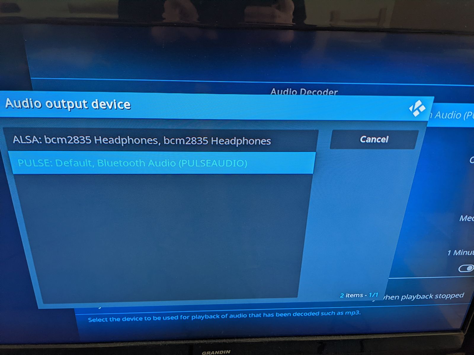

- Attached log
- I cannot select an audio output device in GUI (see image)

With dtparam=audio=on nor audio_pwm_mode (uncommented + reboot)
- Attached log
- I have the choice between 2 audio output devices in GUI (see image)
If I select ALSA: bcm2835... I have audio through the anolog output only (jack 3.5mm) but not through HDMI.
The other choice PULSE: Default does nothing and I am in the same situation than without dtparam=audio=on.

Do not hesitate if you need additional info.
Thank you for having read my first Libreelec novel...
