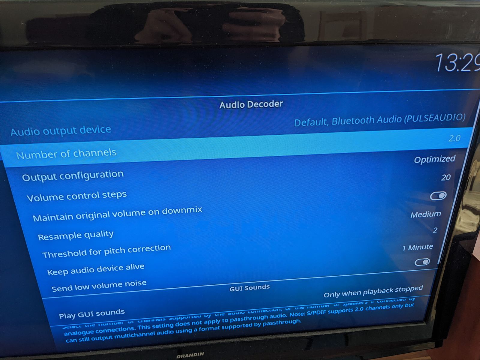

    - I cannot select an audio output device in GUI (see image)

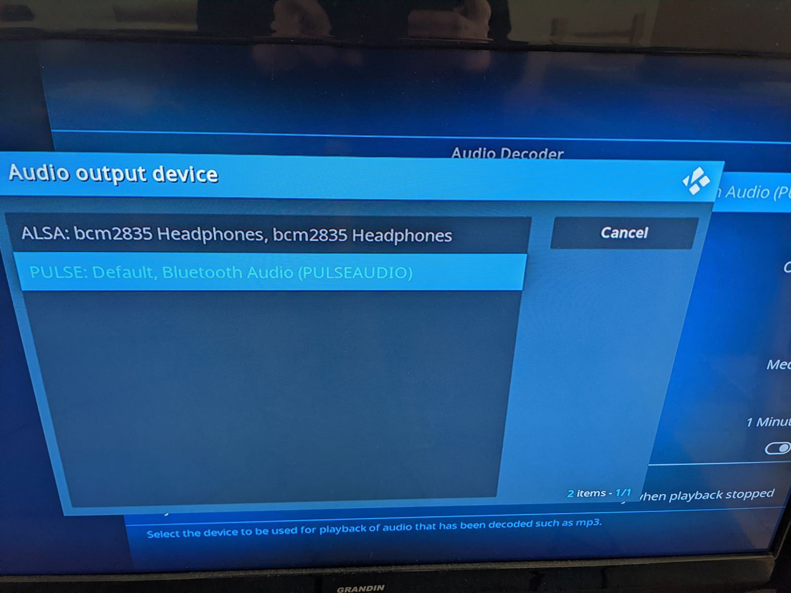

    - I have the choice between 2 audio output devices in GUI (see image)
    If I select ALSA: bcm2835... I have audio through the anolog output only (jack 3.5mm) but not through HDMI.
    The other choice PULSE: Default does nothing and I am in the same situation than without  dtparam=audio=on.
