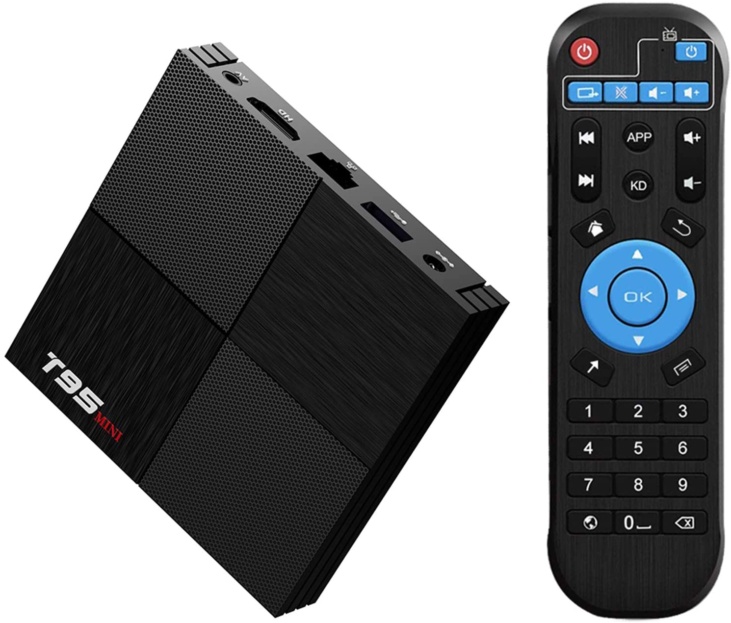

I have seen where others have the Turewell T95Mini running well with the Tanix T6 image. Mine does as well great sound, playback, and 4KHDR. My problem is if I power off I get stuck on a black screen and can not power it back on without unplugging the device and plugging it back in. The log throws no errors on shutdown so I would imagine this is a remote problem as it will shutdown but not turn back on. I will include a pic of the remote and device. Any help is much appreciated as I would really like to use this box and have my hard disk power down.
T95Mini Remote Power

Alright got the remote working that came with the box here is the output for power. I am including my remotes .toml converted to text if that helps. With this and powerarmour's logs maybe we can get this thing going.

I've got that same remote too (I've got a collection of them from various TV boxes), none of them seem to work by default with either LibreELEC or CoreELEC, you have to set them up manually if you want to use them.
