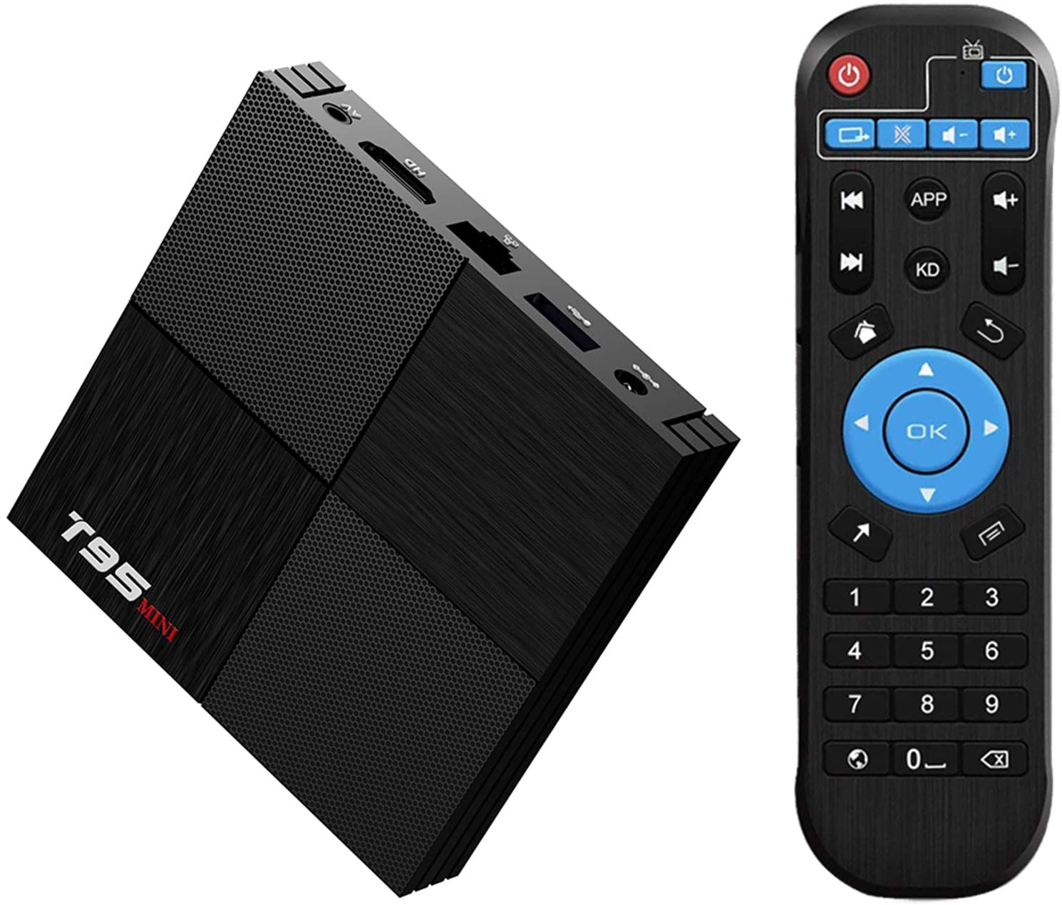

    Alright got the remote working that came with the box here is the output for power. I am including my remotes .toml converted to text if that helps. With this and powerarmour's logs maybe we can get this thing going.
    LibreELEC:~ # ir-keytable -t
    Testing events. Please, press CTRL-C to abort.
    6542.406955: lirc protocol(necx): scancode = 0x2fe40
    6542.407001: event type EV_MSC(0x04): scancode = 0x2fe40
    6542.407001: event type EV_KEY(0x01) key_down: KEY_POWER(0x0074)
    6542.407001: event type EV_SYN(0x00).
    I have seen where others have the Turewell T95Mini running well with the Tanix T6 image. Mine does as well great sound, playback, and 4KHDR. My problem is if I power off I get stuck on a black screen and can not power it back on without unplugging the device and plugging it back in. The log throws no errors on shutdown so I would imagine this is a remote problem as it will shutdown but not turn back on. I will include a pic of the remote and device. Any help is much appreciated as I would really like to use this box and have my hard disk power down.
