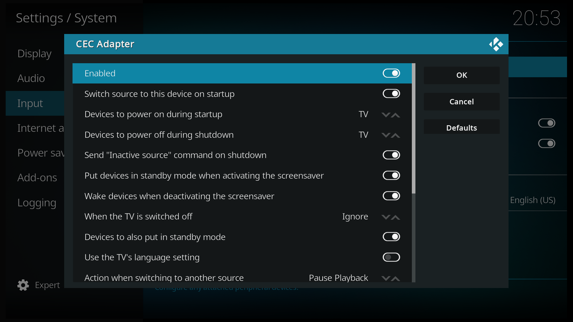

  • Try disabling "wake devices when disabling Screen saver option" and "put devices in standby mode when activiting the screensaver" and see if that combination helps resolve your particular issue.
    ---edit---
    oh and also disable "Devices to put into standby mode"
    ---edit---
    Thanks for the suggestions.
    This unfortunately did not work.
    My goal is for the TV to power off when Kodi screensaver is activated and power on when Kodi screensaver is deactivated.

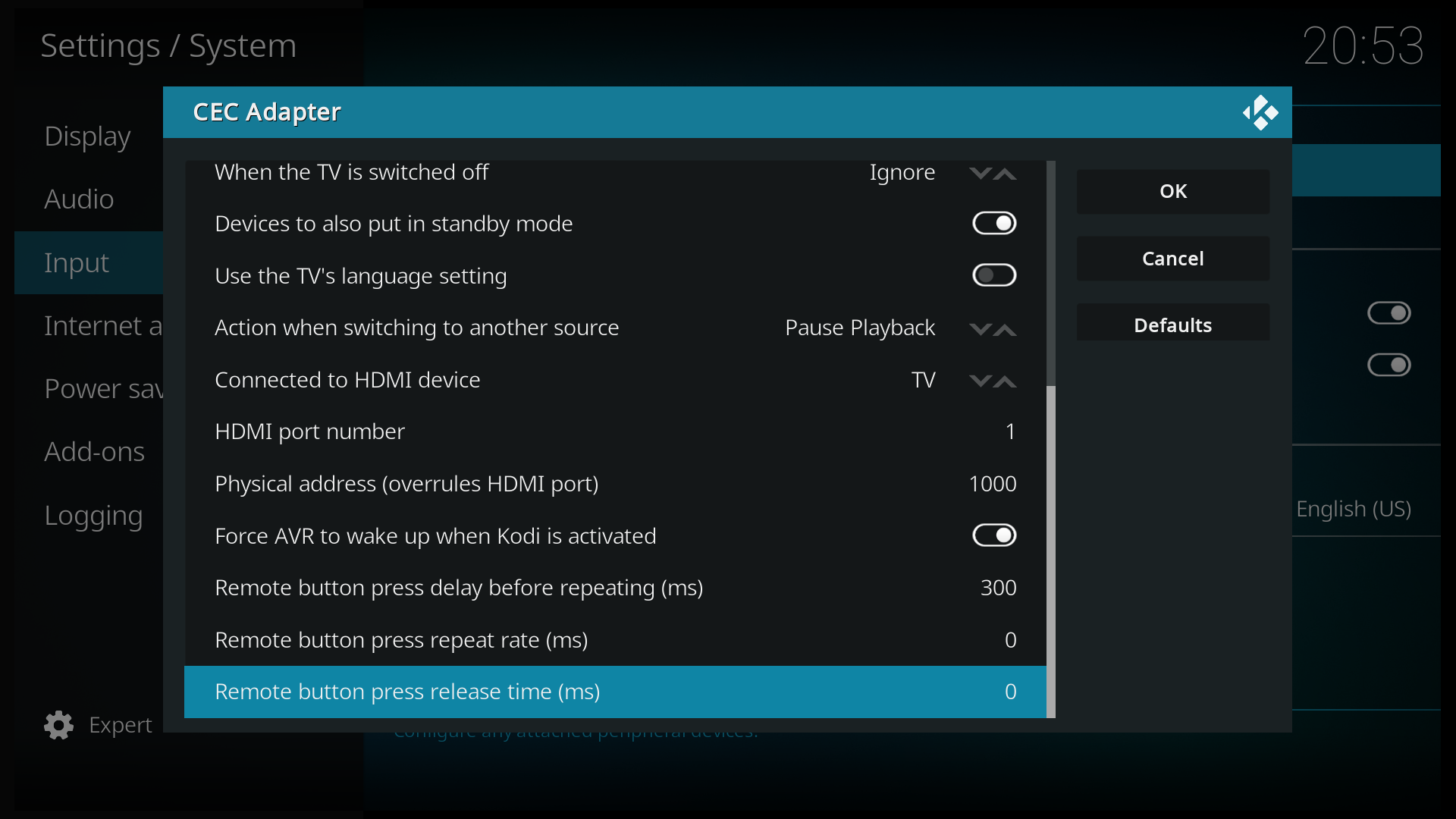

  • Sorry, I didn't understand how you connect Pi4, Soundbar and TV
    Is it:
    a) Pi4 -> HDMI -> Soundbar -> HDMI -> TV
    or
    b) Pi4 -> HDMI -> TV <- HDMI <- Soundbar ?
    If it's "a" than
    1. Question:
    In your second Screenshot "Connected to HDMI device" is set to "TV"
    Can you change it to something different like "Soundbar" ?
    Because your the Pi4 is not connected to a TV but to a Soundbar.
    2. Maybe the Problem lies not within LibreElec and the Pi4 but in the Soundbar which will not send a "Turn on" Signal over the HDMI-Cable to the TV when you disable the Screensaver of the Pi4.
    This would be an Explanation why it's working when you connect your TV directly to the Raspberry.

  • Thanks for you help. It's B
    I have tried all of that.
