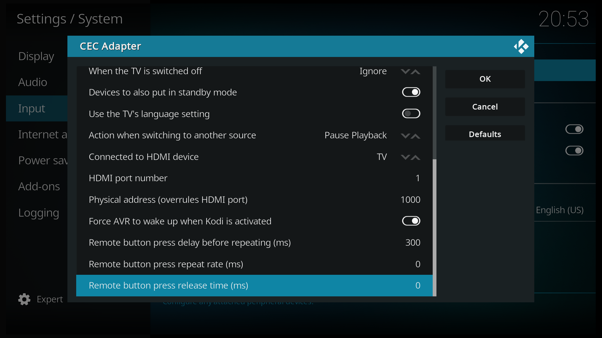

    Try disabling "wake devices when disabling Screen saver option" and "put devices in standby mode when activiting the screensaver" and see if that combination helps resolve your particular issue.
    ---edit---
    oh and also disable "Devices to put into standby mode"
    Thanks for the suggestions.
    This unfortunately did not work.
    My goal is for the TV to power off when Kodi screensaver is activated and power on when Kodi screensaver is deactivated.

    If I turn off the option "Force AVR to wake up...", nothing starts when the screensaver is deactivated.
    The goal is for Kodi to turn the TV off when activating the screensaver and turn the TV on when deactivating the screensaver which only seems to work if the soundbar is not connected with HDMI ARC.
