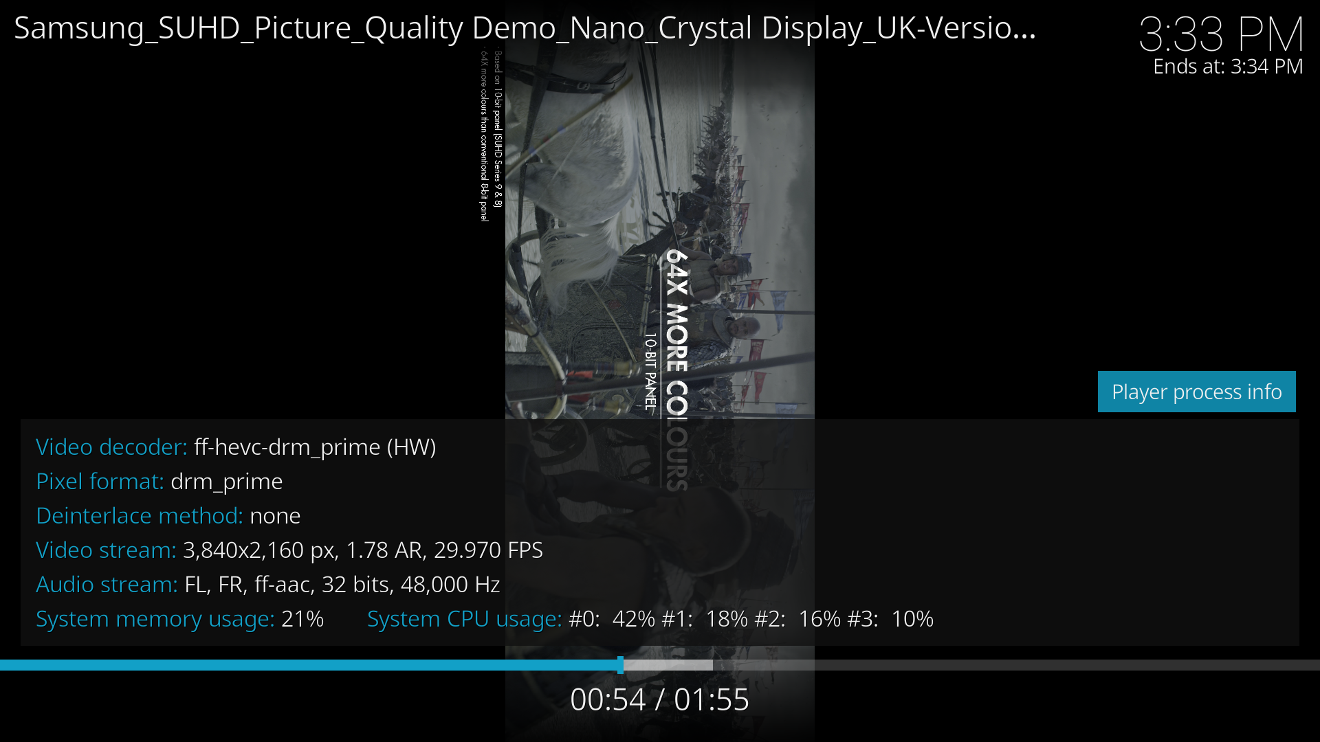

Play a video, bring up properties, change the orientation, then "set as default for all videos" and it should be persistent? (from memory, so might not be exact wording of what you see on-screen).
H6 doesn't support video rotation via direct to plane rendering. I guess it should be possible via EGL rendering.

Allwinner H6 is SoC which powers this box. Actually, I'm not sure if direct to plane rendering supports rotation with any SoC currently. As I said, try with EGL rendering.

I have no idea, I don't use portrait mode nor Android. However, if Android has rotation implemented, it's also done via EGL (GPU).
