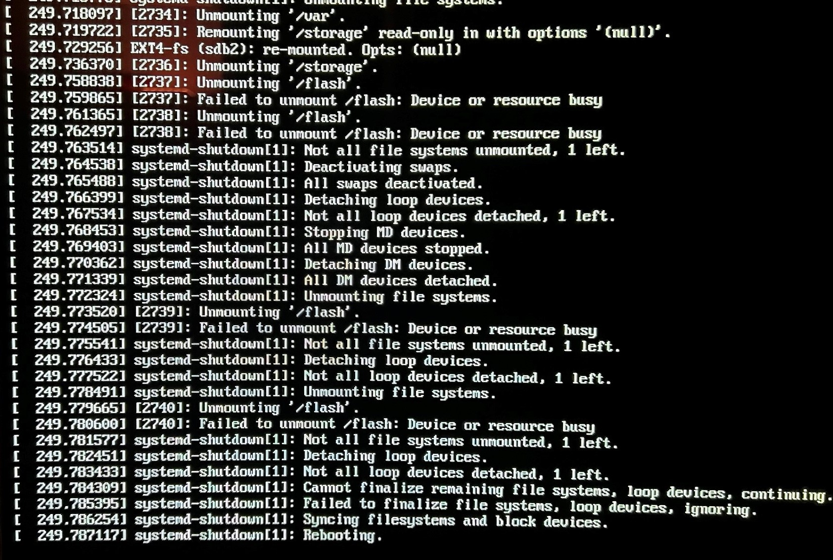

    Problem: Ever since the first beta versions of LE 10.0, I've been facing the same problem - as soon as I turn on the CrazyCat driver to make my TBS satellite card work, the driver crashes the very first time LE starts. Thus I can't run TVHeadEnd and other strange things start happening with the system, like the system can't shut down or restart, it always "stops", or "freeze" on the same shutdown sequence.

  • I try to assemble an image with a more recent version of the TBS driver maybe this helps. Sadly this is all clusterfuck and every time you bump the drivers something else is broken. That's sadly the pain with drivers that are not at the linux kernel. Very likely a situation that get never fixed.
    I let you know when I have assembled a new image.
