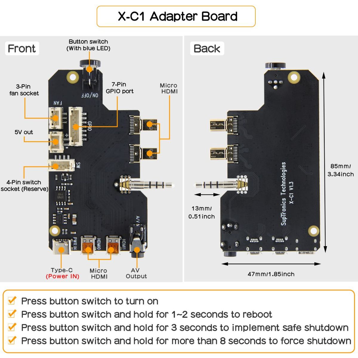

Any way to get the Geekworm/SupTronics X-C1 addon power board safe shutdown to work in LibreElec, on an RPI 4?
  • From what I can gather it seems to be a simple GPIO interface - they have instructions for specific OS's here but mention that it's "unsupported due to the inability to modify the system in LibreElec".
    That... doesn't sound right to me, and I get the feeling it was more that they didn't want to bother figuring out how to do it themselves.
    So has anybody else used this or something similar and figured it out? I've done quite a bit of googling and can't really find anything specific to this board.
    Thanks in advance.

    What I'm more interested in is the power button functionality. I want to build a tiny HTPC with a 2tb 2.5" hdd in it, so the ability to actually shut the Pi off (or put it in a halt/suspend/whatever it's called state) would be very advantageous. Don't wanna have the HDD spinning constantly.
    If push comes to shove I'll just use a different add-on board with a simple push-button and use the standard gpio-shutdown commands. I just like the all-in-one solution that kit presents.
