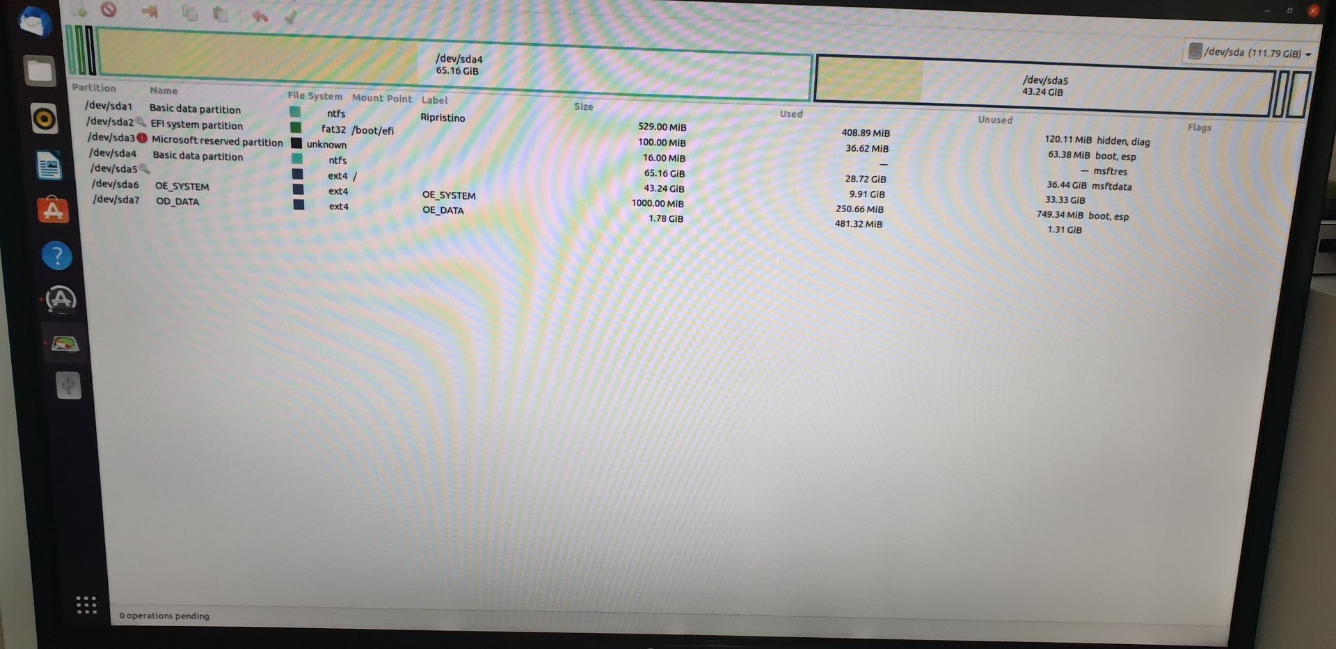

Here is what I see from gparted, if I remember well, sda6 and sda7 are Openelec partitions.
Are them enough?

The system partition is 1,000 MB, so that is more than enough.
The problem is the data partition. It's only 1,78GB in size. Less than 2GB. With a couple of add-ons and the thumbnail cache for a decent movie and tv collection, something like 4GB and higher is recommended.
I have no idea what /dev/sd5 contains but that ext4 partition seems big. You could resize that some 4GB smaller, move up both OE partitions, and then increase the size of the /dev/sd7 data partition with that 4GB to the disk's end.
And also rename the labels of sd6 and sd7 while you're at it.

the sd5 is linux
i'm going to try to resize the partitions
I'm not able to resize the sda5, I believe because it's the linux and I'm trying to resize the partitions from linux lol.
i'm going to try with an external usb

Yes, external boot from a GParted Live (or Parted Magic) device will allow resizing sda5.
ok I did it!
don't know why but I was not able to move the last mb, so I have a partition of 1mb at the end...
anyway, i'm stuck with the update. I can reach the nuc via windows but it asks for login. I tried root/root, root/openelec, admin/openelec but nothing works.
