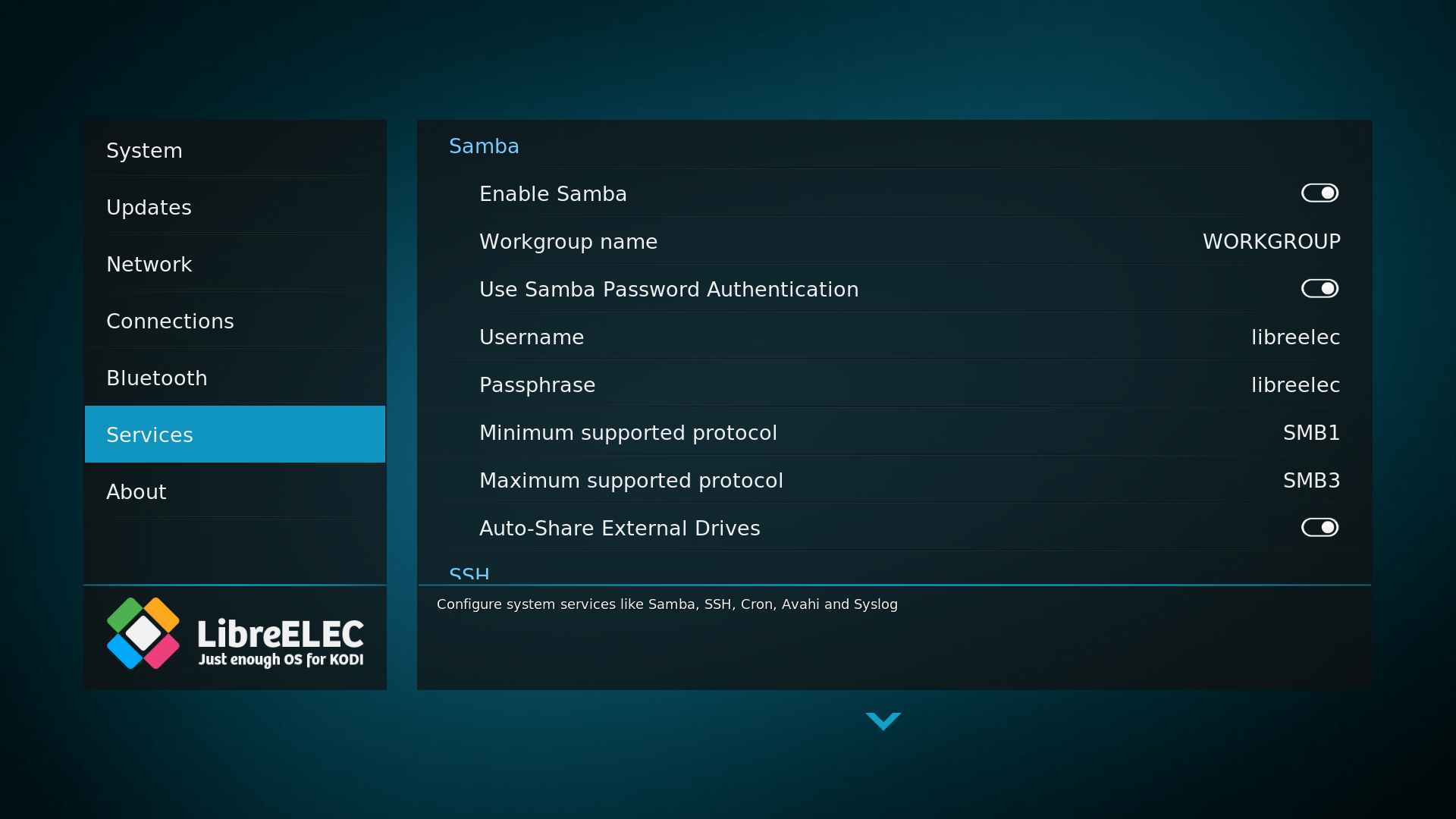

Hi,
change under ....
Addons -> LibreELEC Configuration -> Service -> SMB
minimum smb version to smb 1
maximum smb version to smb 3
i think then you see the smb server under your windows!
Regards

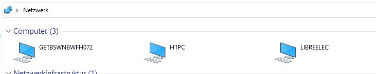

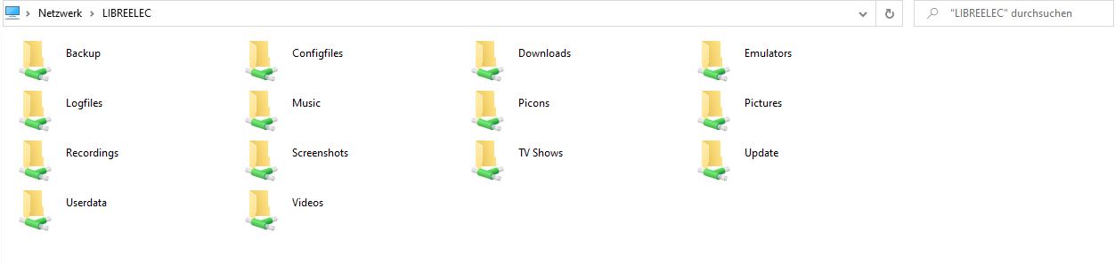

With this config i see the smb share under Windows 10!
change the settings and reboot!
after the reboot, refresh the Networkahares in windows 10!
Normaly then you must see the folder!
