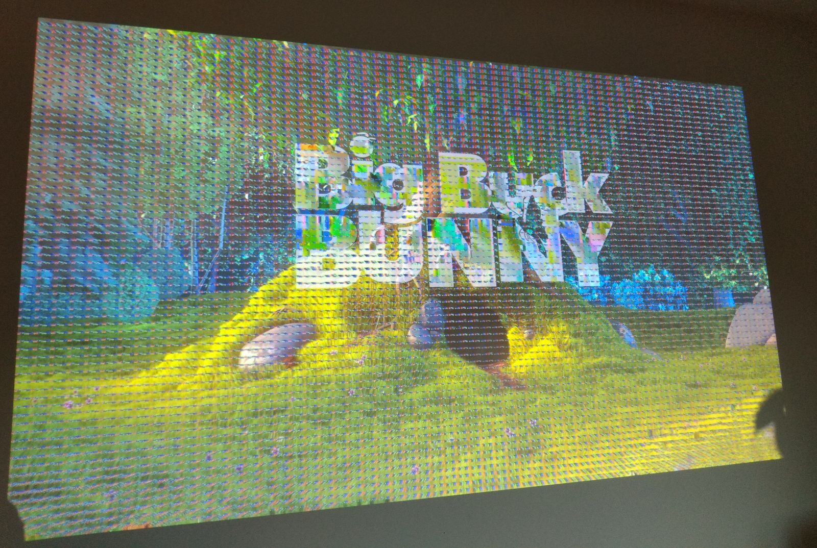

    However there's a problem with playback of H264 video. I've also tried mpeg4, that seems to work fine. But any H264 encoded movie, or stream (I tried Vimeo), comes out totally garbled. In some films some i-frames seem to render okay, but most of the time the picture is so garbled that it's almost inconceivable. Here's an example picture, most of the time it looks even worse:

  • Sure. I copied "Big Buck Bunny" to the SD card. That movie has less artifacts than most other H264 encoded movies I tried. It doesn't make any difference though if it's played from SD card or from a network share. The artifacts appear at the very same frames, it's all very reproducible. The first artefacts appear about 10 seconds into the movie. The scene with the bird starting at 0:16 is rendered cleanly again, the next scene switch at 0:23 starts with artifacts. I've taken the attached picture at around 0:26:

    That may not prove anything. Most notebooks' USB-C power supplies only provide limited power at 5V. They use the smart capability of USB-C to change voltage and may then switch up to much higher voltage and current. I don't think that the Pi does this smart voltage changing, and so it might still be constrained by limited power availability unless the 5V capability of your other supply at least matches that of the Pi power supply. Certainly your screens shots suggest a hardware or power related issue.

    When the video is corrupt, and you bring up OSD, is that clean, or have corruption?
    The OSD is clean. I can see that the video below is corrupted, but the overlay is rendered cleanly.
