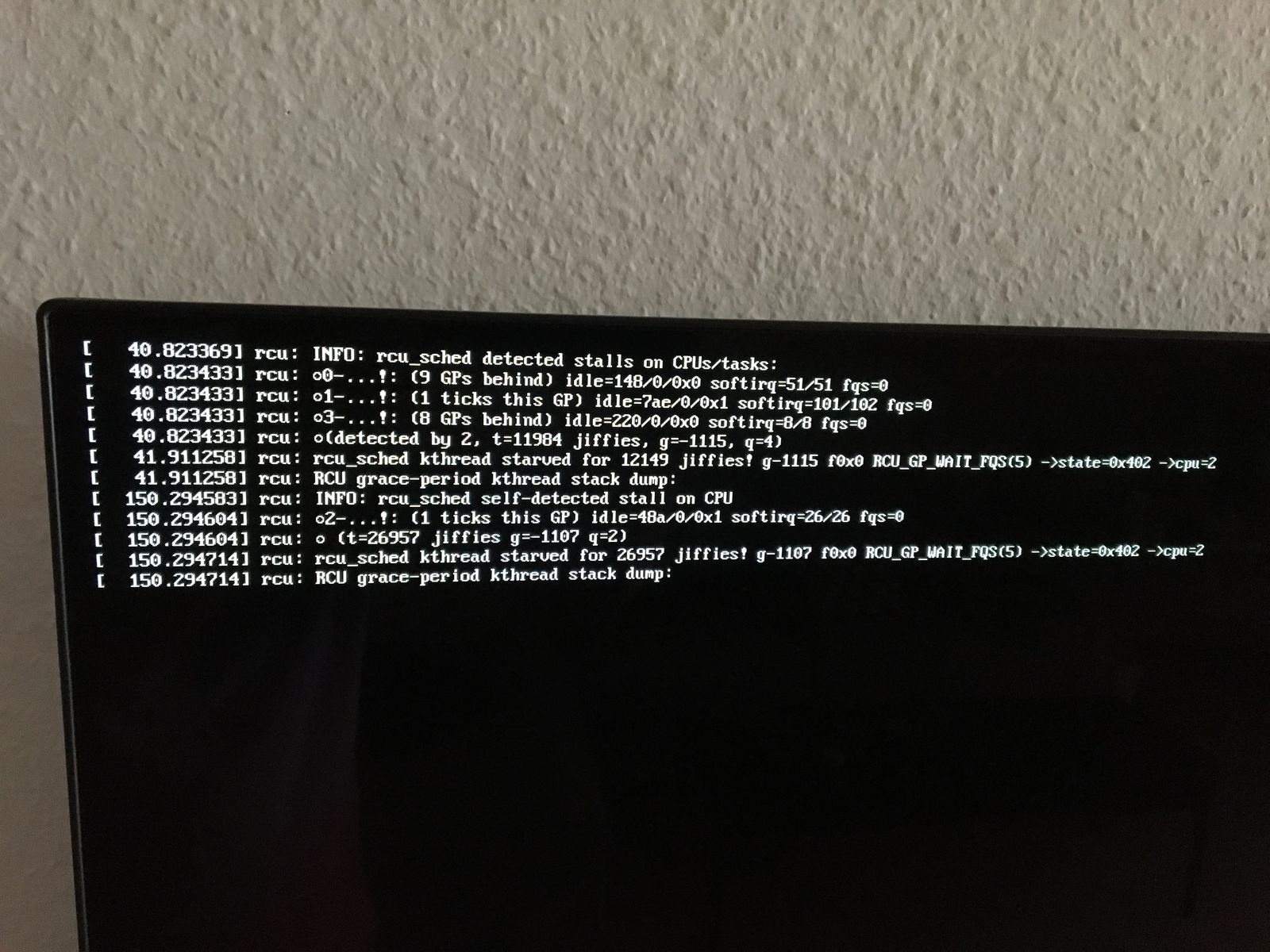

    When I boot, I see the rainbow, then it hangs with a black screen and a `_` in the top left corner. Nothing happens then, and the device isn't visible on the network.

  • As a last ditch effort, I tried the 9.2.6 image with LE10's boot partition. It sorta boots but drops me into an emergency shell. I can't really see what's going on because it uses 4096x2160 and my TV is 3840x2160 so most of the output is truncated and invisible.
