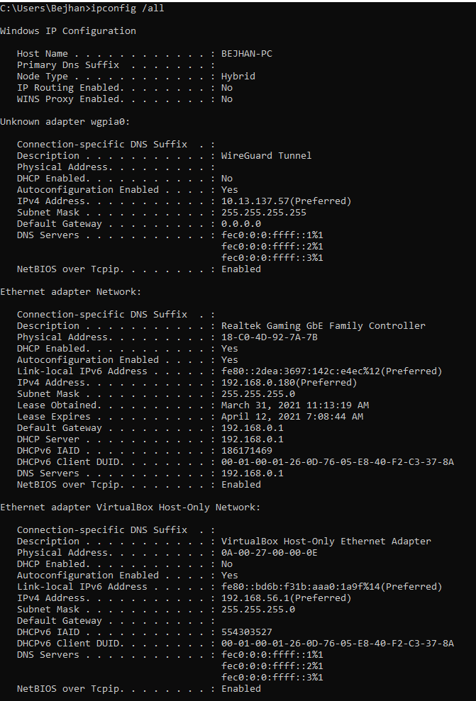

    As you suggested, the strange IP address belongs to a secondary adapter on BEJHAN-PC:
    This particular IP belongs to a VPN tunnel but I have a VM running too, which would also be problematic:
    LibreELEC:~ # nmblookup BEJHAN-PC
    192.168.0.180 BEJHAN-PC<00>
    192.168.56.1 BEJHAN-PC<00>
    10.13.137.57 BEJHAN-PC<00>
    As you suggested, using the IP address instead of the hostname in sources.xml solved my issue:
