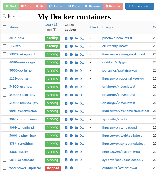

  • Sorry, if you are using an addon to install docker transmission, I don't use this and I can't help you. I have many docker services installed and they have all been installed from the SSH command console, and for this I have needed to study the installation parameters of each one of them, and above all, I always install the docker portainer service to manage the other containers to verify they are running finely, check the storage locations, and do checks within each container.
    The most surprising thing about your case is that it seems that you cannot find the files related to your addon transmission. My recommendation is that you spend a little time studying docker and also install the docker portainer service to see what happens to your docker transmission service.
