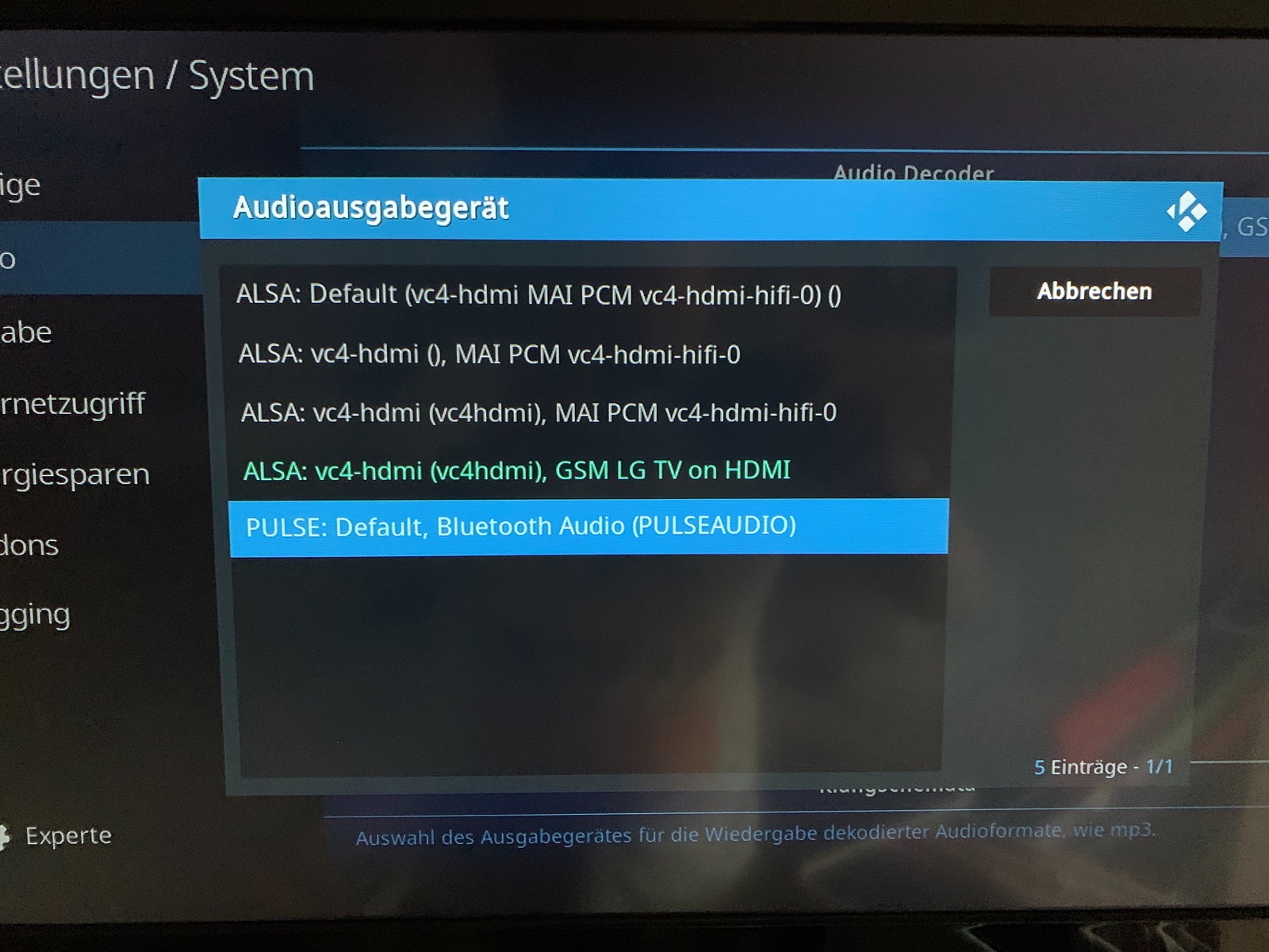

  • I use a Pi4 and would like to setup libreelec to use my "soundsystem". I had to install libreelec20 to run netflix and Prime. Now the Option to get the sound out of the 3,5mm Jack disapeared :C
    Can you help me with this?

  • Libreelec20 .. Really? LibreELEC 10 is not even officially released yet.
    Options don't just simply disappear. Can you make a screenshot of the audio output section with the devices listing?
  • Options don't just simply disappear.
    I am afraid in this case it really "disappeared" between LE versions, AFAIK also some update in past (most likely some Nightly build a couple months ago) replaced the /flash/config.txt with some default one, different from previous so the original settings was lost.
    Perhaps the dtparam=audio=on should be included in /flash/config.txt by default as missing this audio output option (Analogue jack) is confusing many LE / RPi 4B users.
  • Very few users seem to have been using the analog audio output and those that did complained that the quality was bad, volume level quite low and/or that they got crackling audio during video playback (which are all known issues and to fix the latter audio_pwm_mode=1 is needed in config.txt which leads to even lower quality audio output). The simple solution in most cases was to use a cheap audio HAT or USB audio adapter instead.
    Therefore I didn't consider to enable on-board analog audio output by default in LE10 - the feature is still there though for those who want to live with the limitations.
