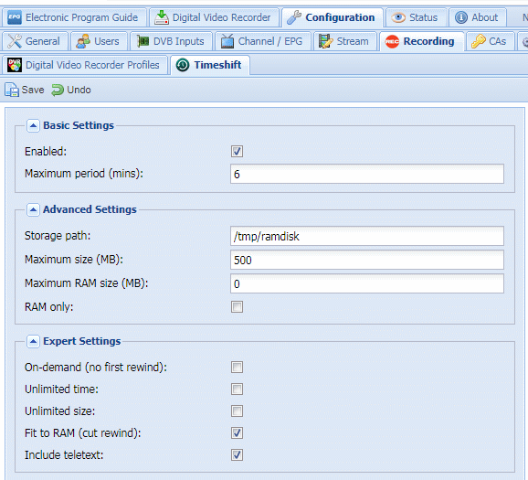

  • As there's no feedback or comment from developers and it seems the Timeshift issue is more worse than better in latest LE 10 Nightly on my RPi / 2GB, I decided to try a different Timeshift configuration.
    As I had no idea what's happening in memory with Timeshift data / how it works, I created a tmpfs mount and instead of RAM Only, I changed the Timeshift configuration in Tvheadend backend to use /tmp/ramdisk with 800 MB size and currently I am testing how this works... At least I can see how the buffer files are created and when are discarded.
    So far it looks that Kodi is sometimes loosing a pointer in Timeshift data (and gets messed) even in this configuration but the Plus is the files are not discarded immediately when this happens. But it's too early to say that's fact - it needs more thorough testing in my environment.

  • Another update - at least there's an issue with Tvheadend backend - Build: 4.3-1940 ~ LibreELEC Tvh-addon v9.80.11.100 (2021-03-10T21:50:53+0100)
    In configuration described above it ignores the parameter Maximum size (MB): and keeps writing buffer files until the filesystem is full or the Maximum period (mins): limit is achieved.
    Even though the Maximum period (mins): parameter is set as the limit (to keep some free space on filesystem), when this limit is achieved, after some time (when moving the Timeshift pointer, perhaps the left border is a critical point), the Timeshift stops working as well as described in previous post... :(
