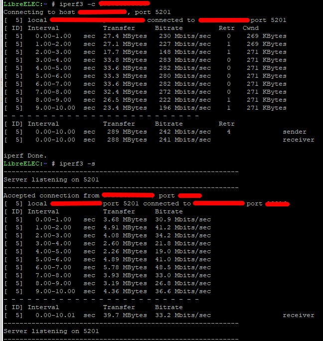

    Please see attached screenshot from iperf3 when odroid is a client with comparison when it's a server. This test also shows huge dicrepancies between upload and download.
