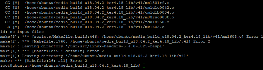

  • I just got an response from the seller with this link: media_build_u18.04.2_ker4.18_lib_201030.tar with his small note, download and install it.
    I didn't got it to work jet. but i wanted to let you guys know. And maybe some of you got lucky.
    Edit: he is also send me an install guide. CompilingTunersDriverForLinux_v1.2
    I have tried that, on my pi with ubuntu and an old laptop x86 ubuntu but I still run in to the same error for both of them...
    Edited once, last by Pascaltje (January 5, 2021 at 2:29 PM).
    I not found any support for USB\VID_0572&PID_689A
    dvb-usb\cxusb contain support for some new geniatech products:
    USB\VID_0572&PID_C68A - T230C V2 (Si2141+Si2168D60)
    USB\VID_1F4D&PID_A681 - ATSC/CQAM USB Stick (mxl603+mn88436)
    USB\VID_0572&PID_A682 - ATSC/CQAM Dual USB Stick (mxl692)
    USB\VID_0572&PID_2886 - T232 DVB-T/T2/C Dual USB Stick (cxd2858)
    USB\VID_1F4D&PID_692F - ATSC/CQAM USB Stick (mxl692)
    si2183, cxd2858, mxl692, rs6000 frontend drivers without full sources,just precompile x86_64 libs.

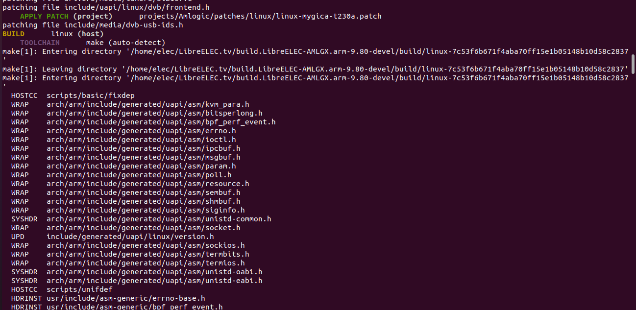

  • Do I come to ask for your help? can you please tell where the error is?
    smp important: How to add new MyGica T230A? · Issue #224 · tbsdtv/linux_media · GitHub
    patches: 8ec77749b81a70c8616e39be4a0e2e0a5a9eb165.patch
    I know you will certainly have a direction, I tried to include this patch in the construction of the chewitt and I get errors related to: drivers / media / usb / dvb-usb-v2 / dvbsky.c
    include / media / dvb-usb-ids.h
    I just edited the patch for amlogic-t230c.patch.
    I directed to: projects / Amlogic / linux / patches.
    Edited once, last by erbas (January 17, 2021 at 2:51 PM).
  • https://www.dropbox.com/s/yu90aa1cww6n…230a.patch?dl=1
    Edit: I updated my patch, please re-download
