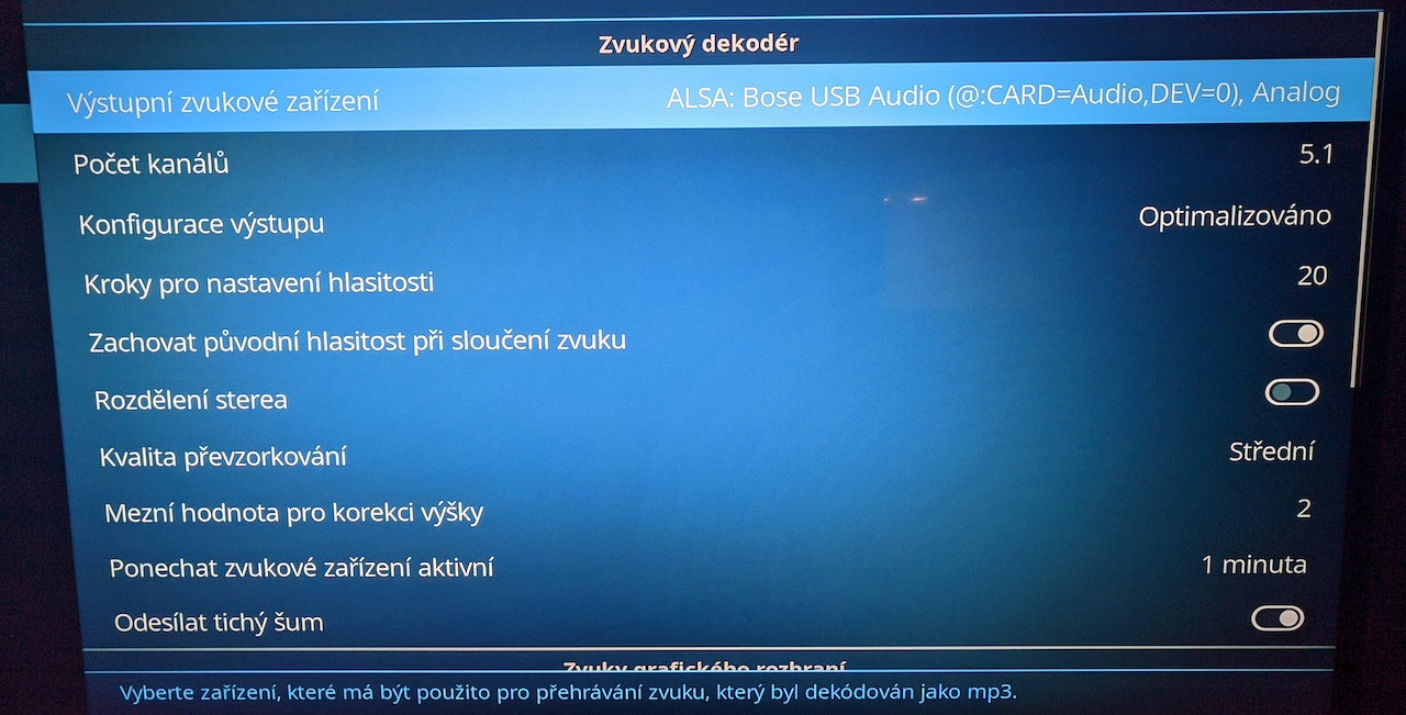

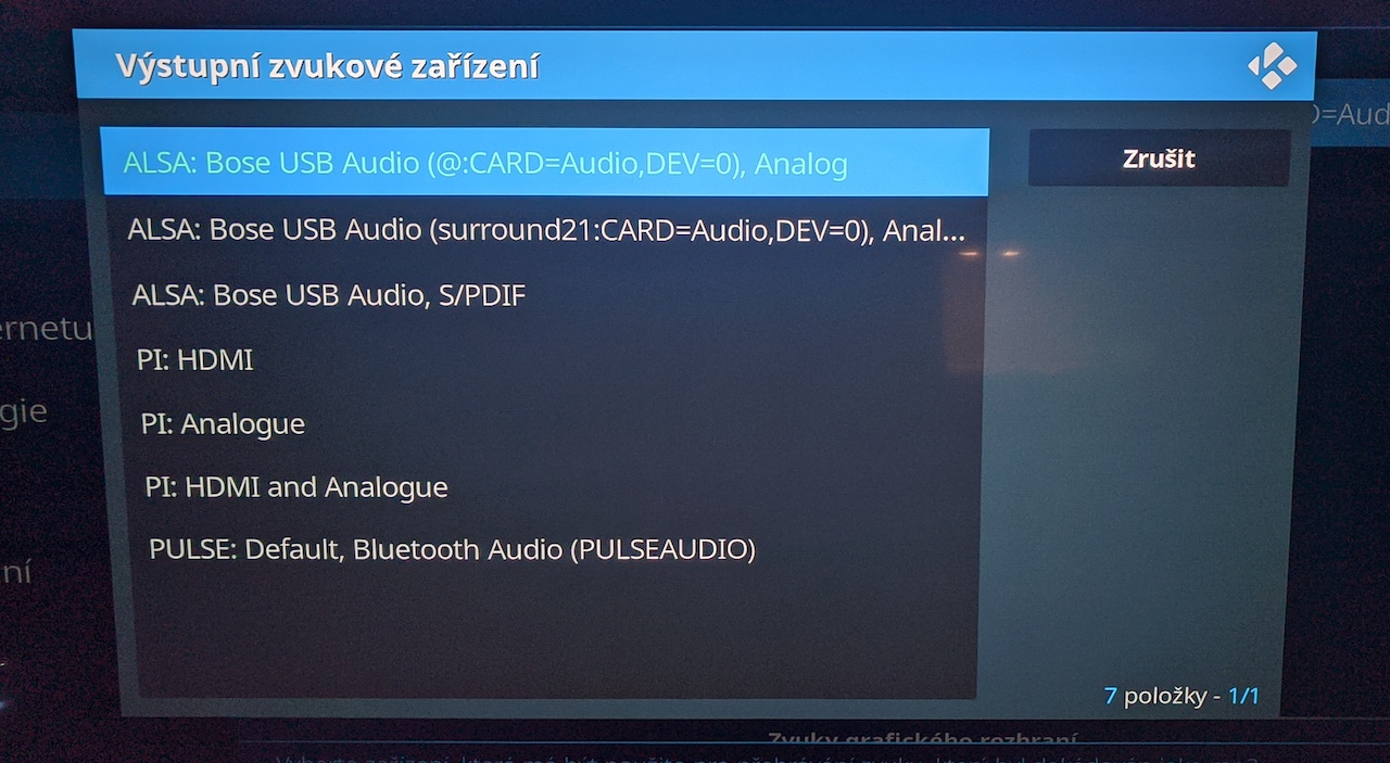

  • Hello,
    fist thank you for this fast, lightweight and optimized KODI distro! I switched to LibreELEC from Raspbian (Raspberry OS) and I have this weird issue with my "Bose USB Audio" connected to the Raspberry under LibreELEC in KODI. Without any change, sometimes is the sound heard from the speakers, sometimes not. All you have to do is press "restart" or power it "on/off", it's like russian roulette, once it works, the second time it doesn't :D
    I had this issue also under Raspbian, but it helped me to disable the onboard audio chip:
    https://superuser.com/a/1045885/491553
    And this works one year under Raspbian like a charm. Before, I tried to set up the device correctly in ALSA, but nothing works except disabling the onboard audio chip mentioned above. I tried the same in LibreELEC:
    echo "blacklist snd_bcm2835" > /storage/.config/modprobe.d/blacklist.conf
    but with no success, nothing change and the PI:XY sound card donť disappear.
    Here is my log:
    http://ix.io/2I1T

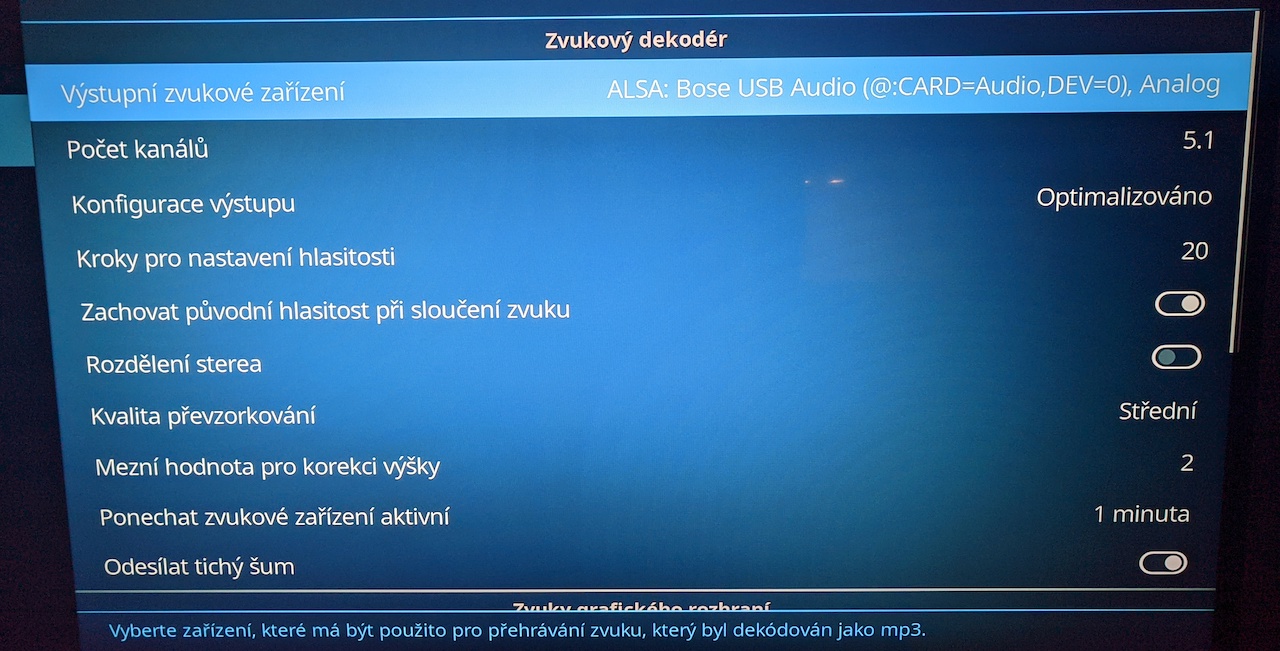

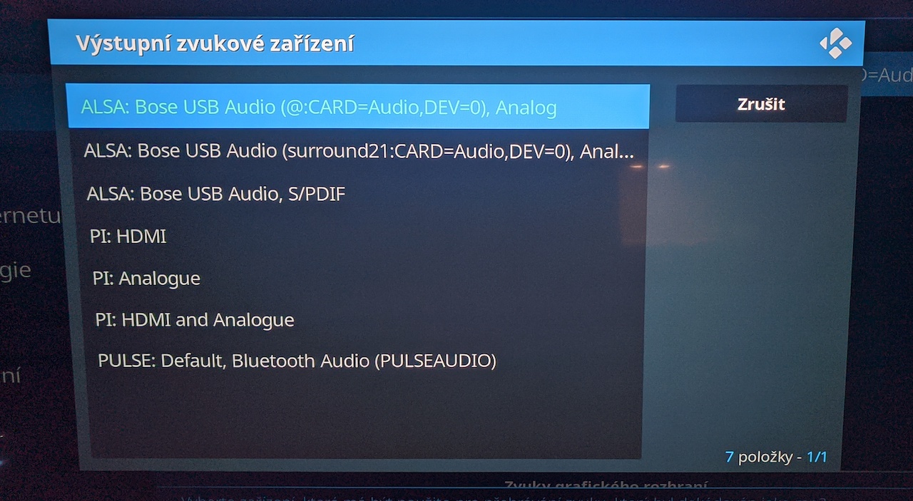

    And some screenshots:
    Can anyone please help me fix this issue under LibreELEC? :)

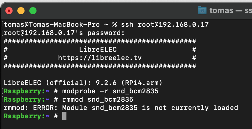

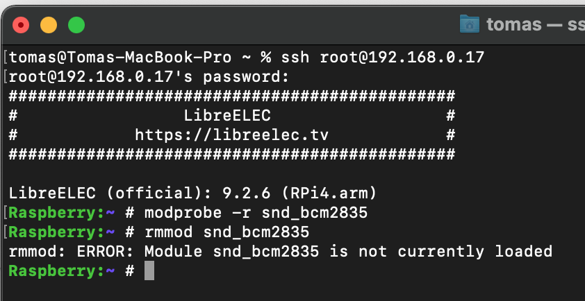

  • OK, so what if you try to unload the module:
    modprobe -r snd_bcm2835
    or
    rmmod snd_bcm2835
    Or comment out by # this line in /flash/config.txt:
    dtparam=audio=on
    Edited 5 times, last by ghtester (December 21, 2020 at 2:58 PM).

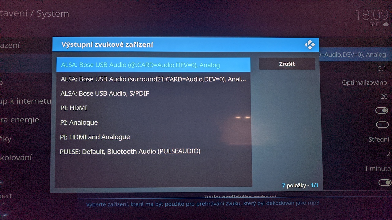

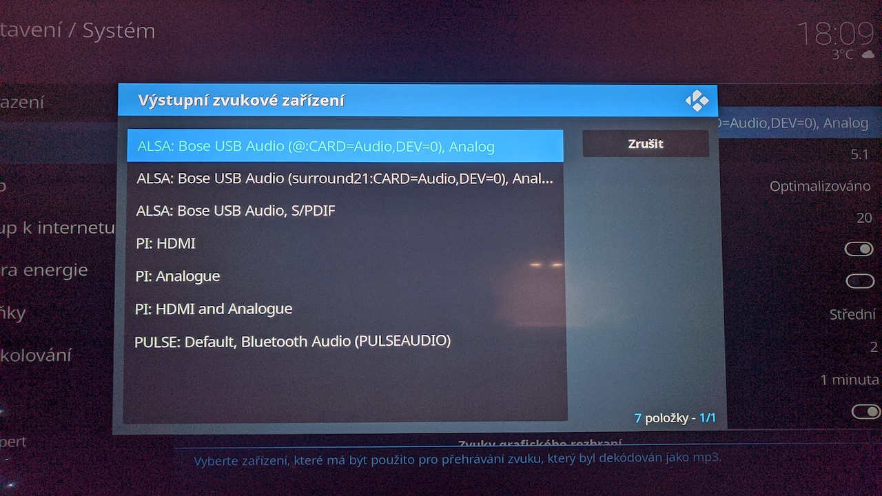

  • and edited /flash/config.txt (after LibreElec restart):
    but nothing changed, the sound issue is still here and PI:audio devices are still listed :(
