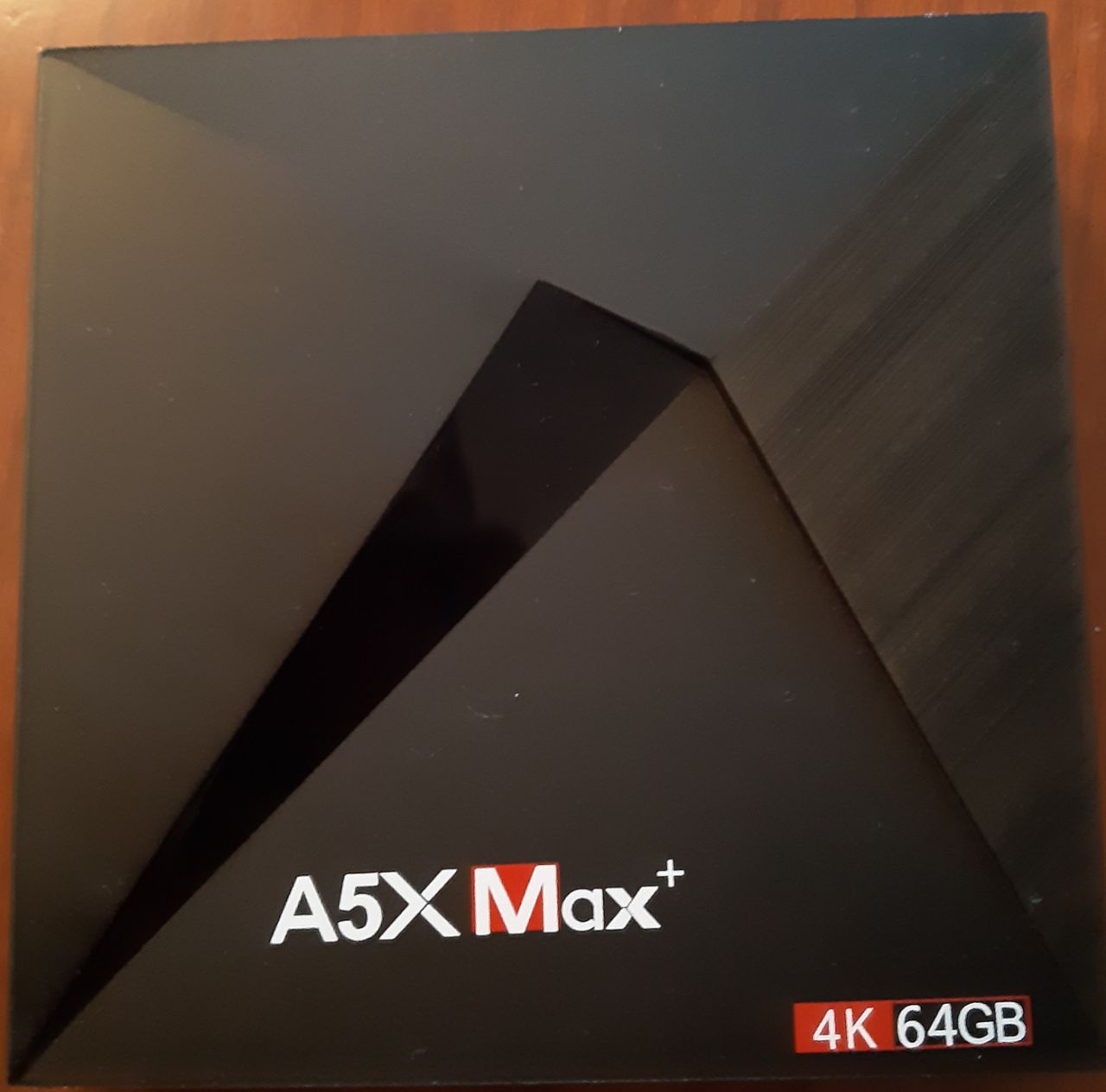

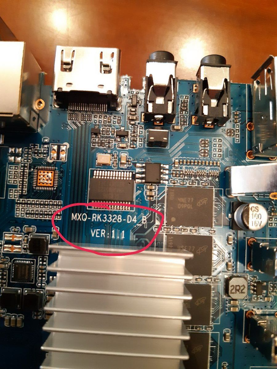

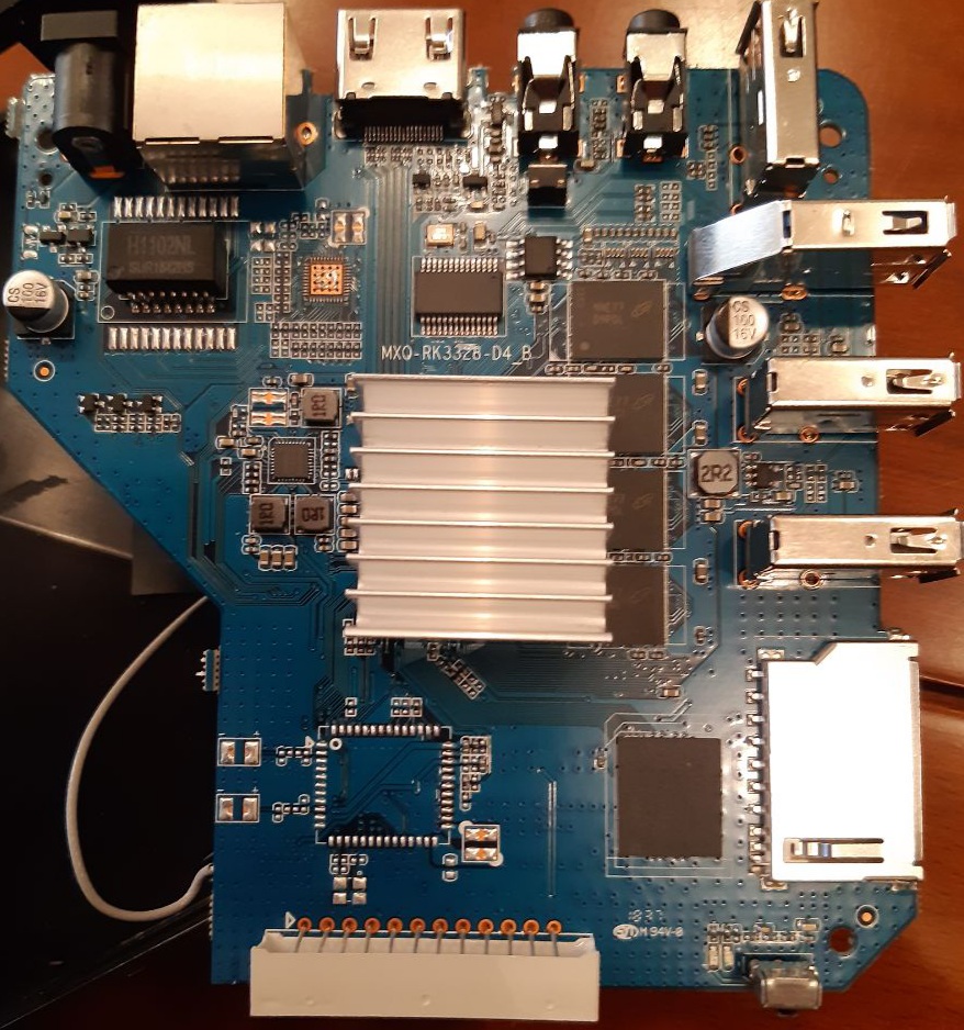

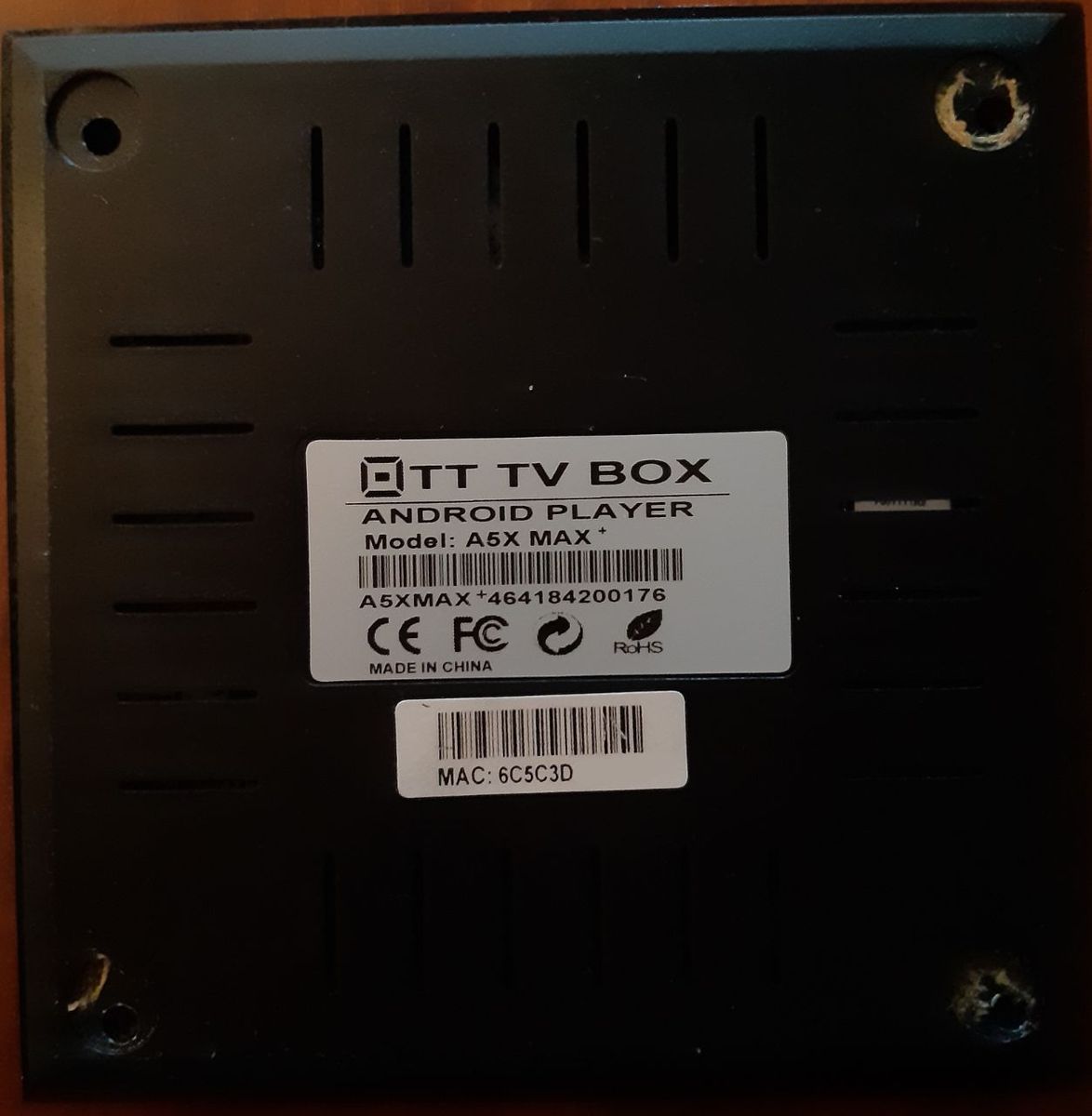

    I have an A5X Max plus, you can see images of it in attachments.

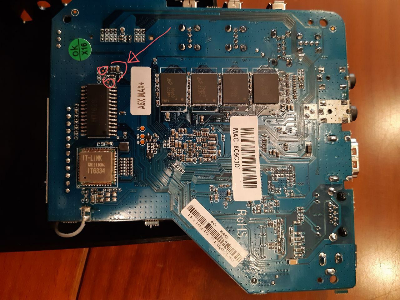

    Boot on maskrom mode, with a clip connecting both points marked on first image on first post of thread while connecting a cable USB-A to USB-A to computer.

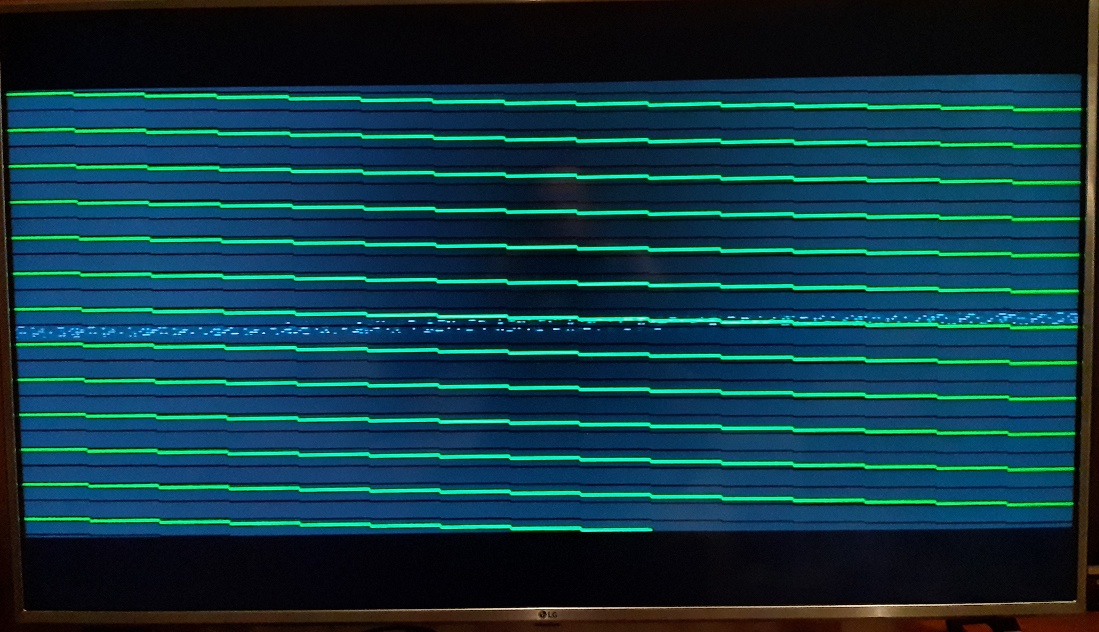

    I see that when videos are opened they are played like in attached image, tested on several formats (mp4, avi, ...) and appear on all format green horizontal bars, tested to change resolution of LE config but it is not corrected. On settings -> Player -> Videos i see that if Allow using DRM PRIME decoder is disabled ,video is decoded by software and it works, but is important to change resolution of LE to 720p to play smooth.
    Is it possible to maintain hardware accelerated video decoding changing other configurations?
    Thanks for your help!
