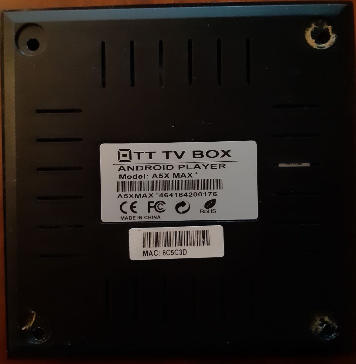

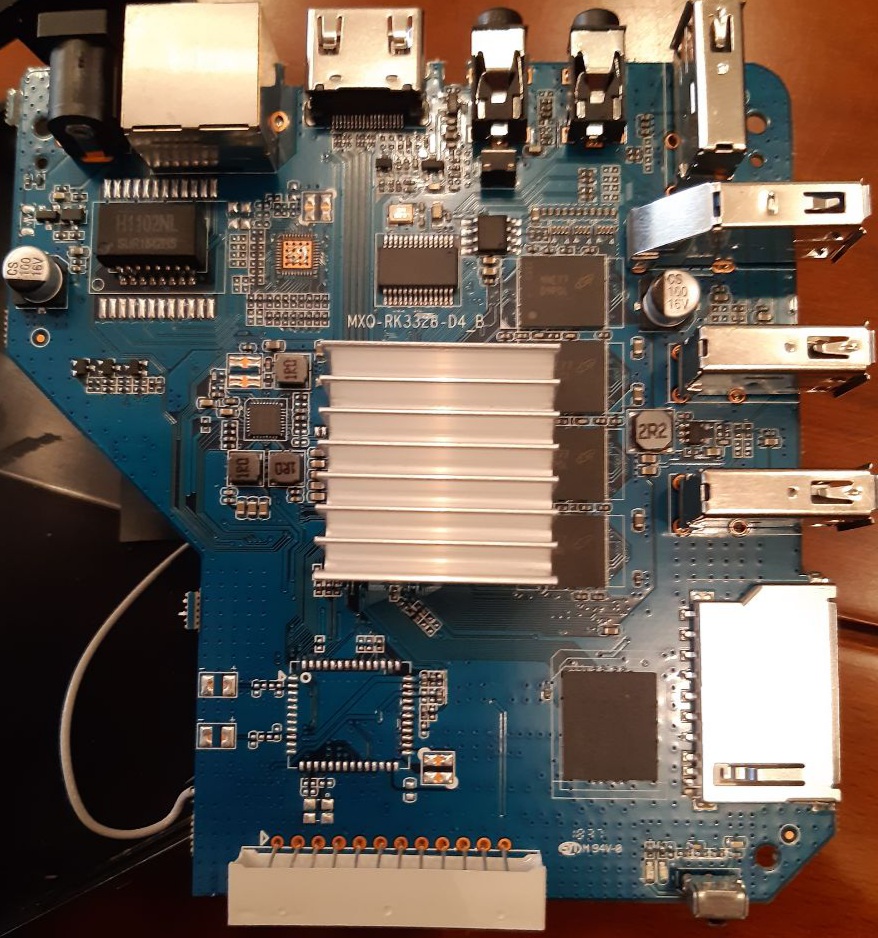

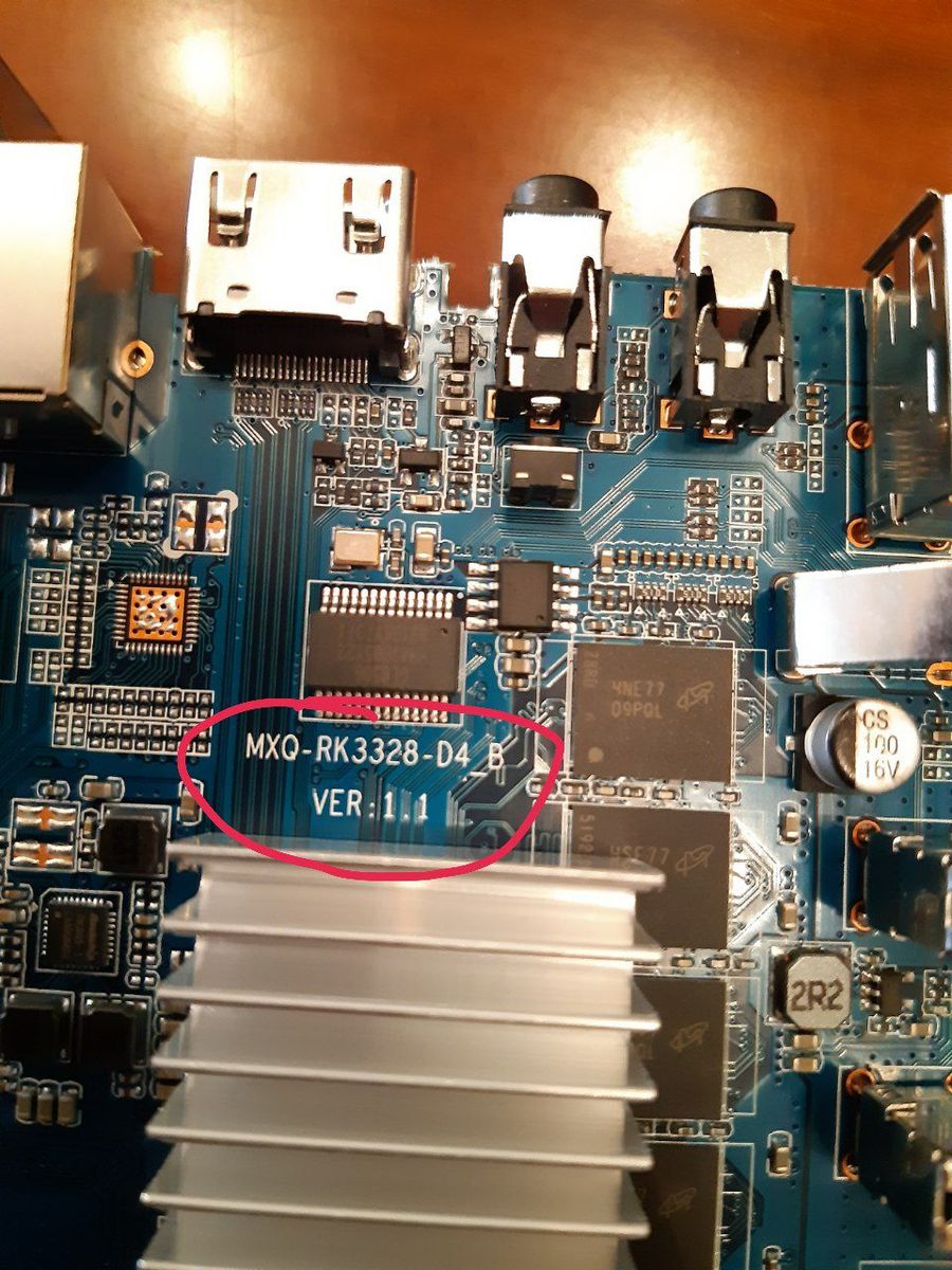

    Hi All!
    I have an A5X Max plus, you can see images of it in attachments.
