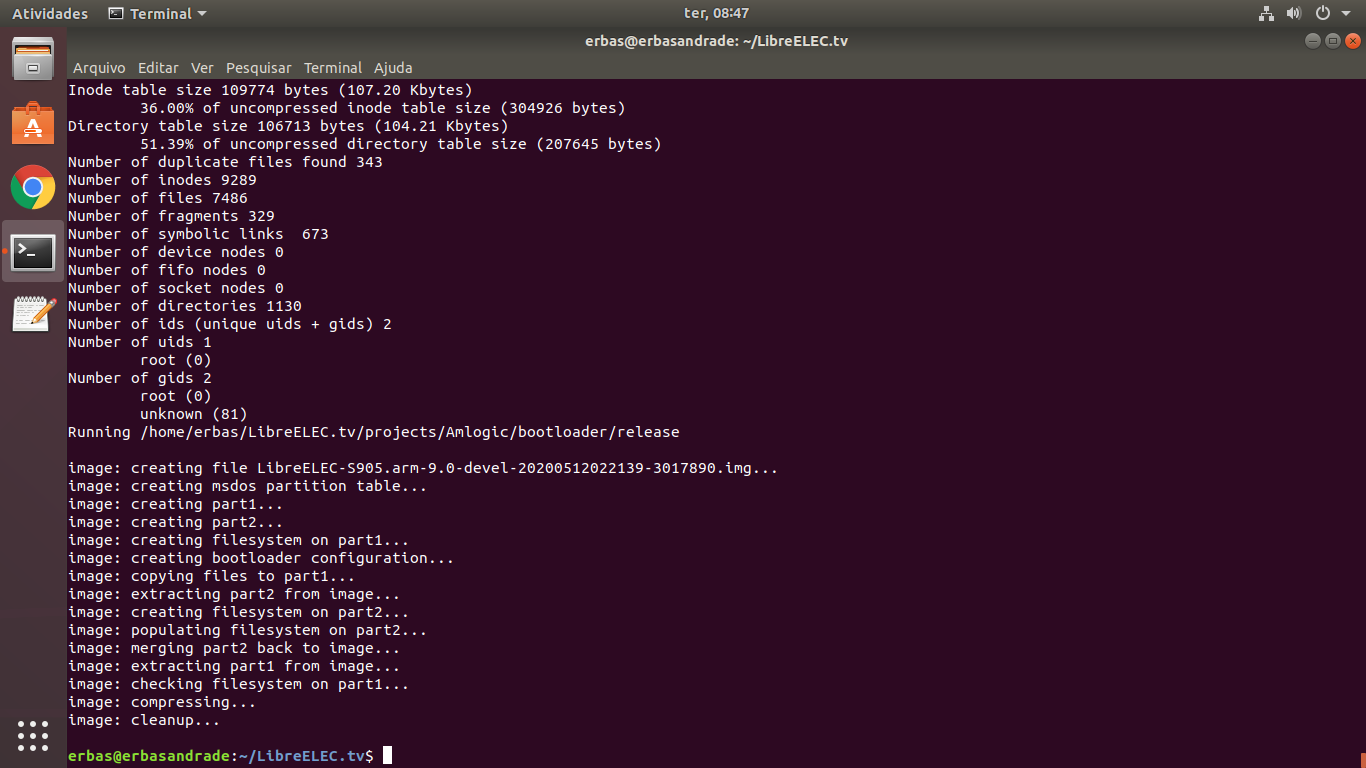

    Well I managed to make the first step!
    Construcão LibreELEC 9.2.1, Commits · LibreELEC/LibreELEC.tv · GitHub
    after construction I put it on an SD card and the crazycat driver was ready for activation.

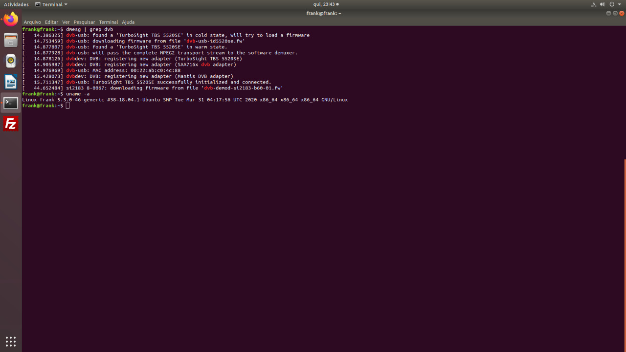

    I connected the TBS5520SE but did not detect tuners.
