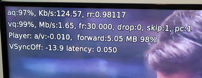

    In having some problems with Simple IPTV where the channels some times are getting stuck by buffer. To mitigate that I raised the Buffer in Advance Settings. But I not sure if was applied.
    I'm getting the same status that I have before config the Buffer.

    I set:
    memorysize with 200 Mb, and the max that goes is 5 Mb, same as before changes.
    readfactor with 5, and download don't go trow 2mb, same as before changes.
    Looking to the Stream info (Shift + Ctrl + O) -- The same was observed before changes.

  • Tnks Da Flex, I did the change to LOG 2 but still could not find where to look if advancedSettings was applied. I searched for the variables memorysize and readfactor but did not find any registration (just that one showing at the beginning showing the advancedSettings.xlm)
    What I observed is that the Forward buffer is coming up to 10 mb, but still not even close to the 200mb configured.
    Another change I did is readfactor = 20, but the download rate did not changed at all. Just an observation, I have a internet Link of 80 mbits.
    So I still believe that the advancedSettings was not loaded...
