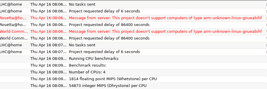

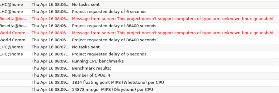

  • Incognito worked, but rpi4 not supported it seems.
    Mar 24 16:53:52 LibreELEC sh[22143]: 24-Mar-2020 16:53:52 [Rosetta@home] This project doesn't support computers of type arm-unknown-linux-gnueabihf

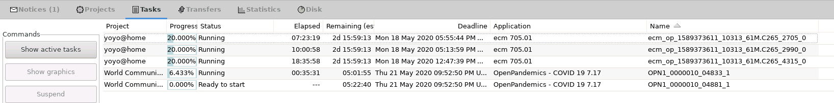

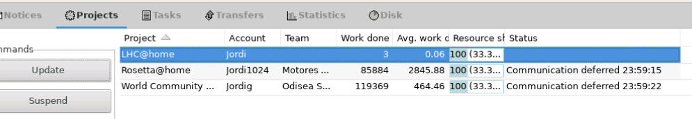

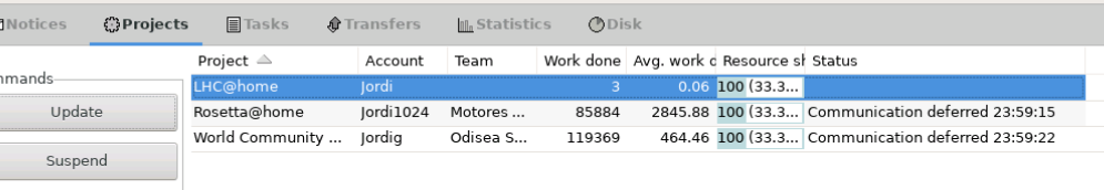

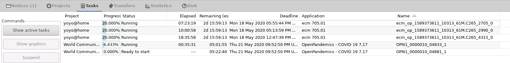

  • Boinc software does work . World Community Grid and Rosetta projects doesn't seem to acept this CPU (even if they announce they work on ARM Android devices), and LHC seems to not send Working Units. Yoyo@home works fine.
    Can't connect to Folding at home software at port 7396, not sure if it works on Pi.
    Update: Performance on the Pi 4 (4gb) is higher than I thought... 1.814 x4 floating point MIPS vs 4.326 x12 on a Ryzen 2600X (with lots of background apps, maybe 4.500 on a clean system...). A pity I can't contribute research at Rosetta and World Community Grid with a Pi that is on 24/7...
  • Boinc's announcement about arm was a bit misleading. It got me excited at first as well. Turns out, they are now supporting arm64, not 32. Even though rpi4 has a 64bit chip, LE runs 32bit software on it (so does raspbian) and that's why it's a no go.

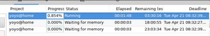

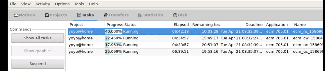

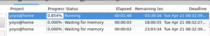

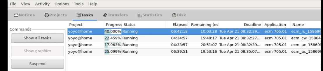

  • Still Yoyo@home works fine under BOINC in my Raspberry Pi 4 with Libreelec 9.2 following your indications :/. Let's hope the way towards kernel 5 is not very long...
    Edited once, last by Jordi1024 (April 16, 2020 at 4:30 PM).
  • I should clarify, it was Rosetta@home's announcement that they would start handing out jobs for arm, but only for 64bit. Other projects on Boinc suppport 32bit arm.
