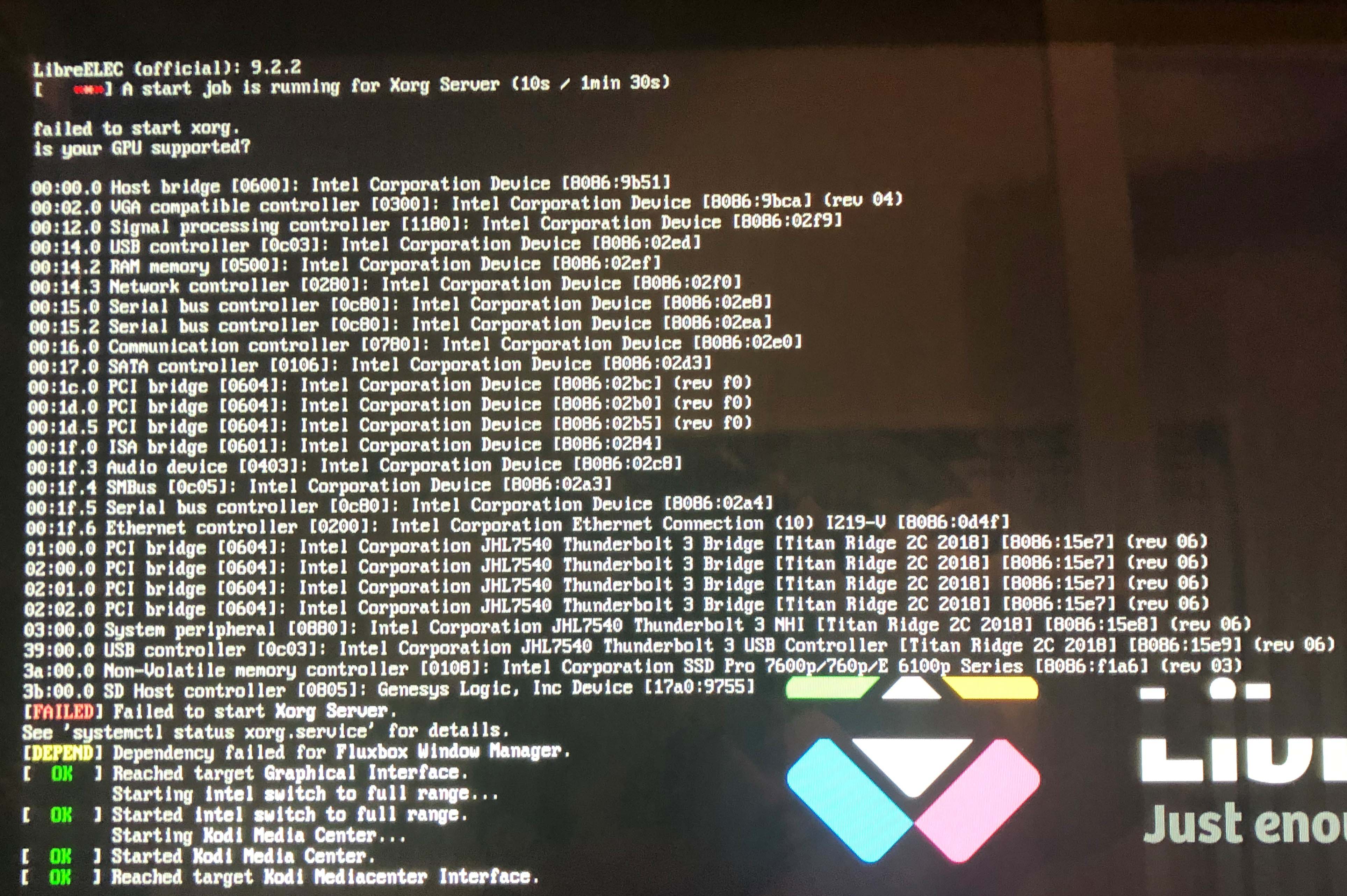

    I installed librelec as usual on the new nuc, installation from the usb media is smooth as usual. when i reboot the system it get stuck here:
    20200131_164420.jpg - Google Drive
    I'm running LibreELEC-Generic.x86_64-9.2.0.img.gz , i thought to try an alpha or a beta version but this is the latest available. Nuc's bios is the last available (rev 037) from intel.
    any idea?
    thanks for the help
    TK

  • I am also playing around with a NUC10i7FNH. I have attempted to install LibreELEC-Generic.x86_64-9.80-Milhouse-20200220230737-#0220-g85b21f7, but I am also hitting the XORG / GPU Error. It looks like everything else is wanting to load properly. I have attached a photo of the boot sequence utilizing the Milhouse 0220 build.

  • After a little bit of playing around with LibreELEC-Generic.x86_64-9.80-nightly-20200324-aeb6e84.img.gz, I am happy to say that the NUC10i7FNH and NUC10i7FNK Frost Canyon Comet Lake NUCs are fully operational!!
    I have an extensive local library with several high bit rate, 4K, Dolby ATMOS, DTS-HD files and they are all rocking!!
    I did a clean build on both systems utilizing different types of drives and all seem to be working perfectly.
    Both systems are running BIOS 39, 16GB RAM, and have the IR sensor configured as RC6. I am able to control both with my Harmony remote configured as a media center remote.
    This should help with everyone's shelter in place!! Thank you all for the suggestions in getting these new NUCs up and running!!
