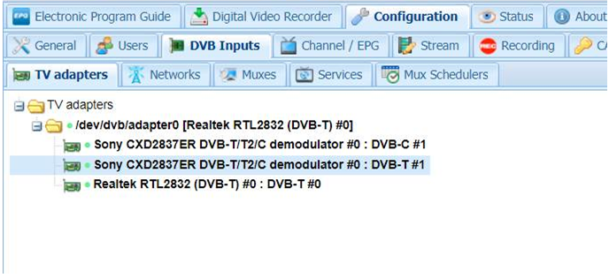

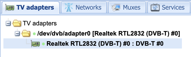

I've connected my tuner, but on TvHeadend I'm only able to see the DVB-T tuner, as shown on image below:
I tried looking at dmesg, but I was not able to see any references to the D2837ER chip: http://ix.io/26in

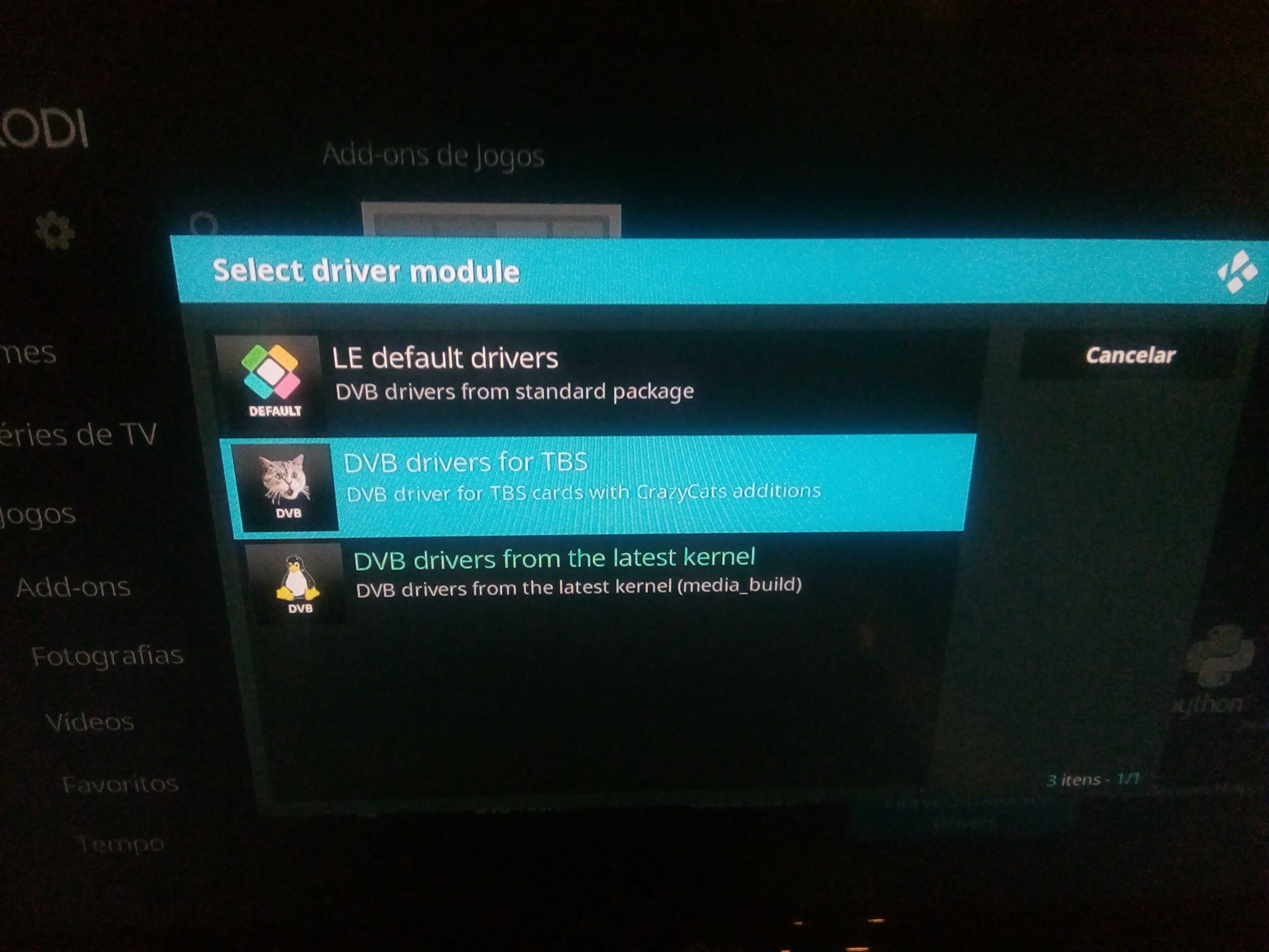

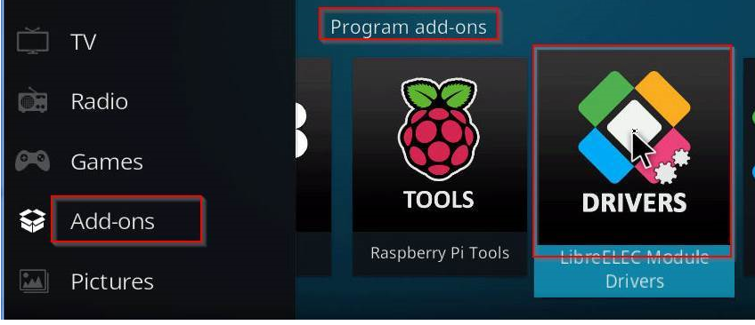

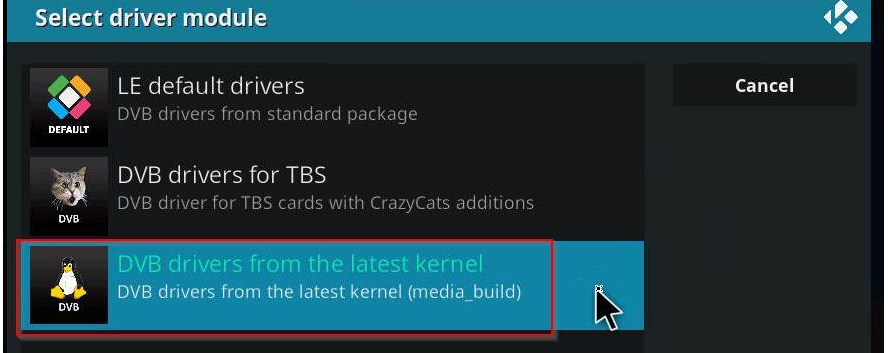

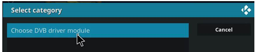

After some online reading, I've seen some comments advising to try enabling DVB drivers from the latest kernel (media_build). So I did this change, like seen below:

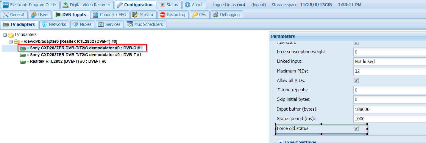

After reboot, TvheadEnd still doesn't show the DVB-C tuner. However there is some progress, since I can see refereneces to D2837ER by looking at dmesg: http://ix.io/26jh
