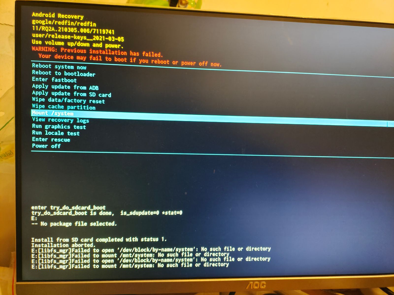

  • I have one TV BOX (RK3566 X96 X6 TV Box Android 11.0 TV Box 4GB 32GB), I want to try to use the LibreELEC on my TVBOX, First I write the image LibreELEC-ARMv8.aarch64-11.0-devel-20230301125115-e014594-rk3566 on TFcard use the BalenaEtcher software at windows 7 system, then I inserd the TFcard in the TVbox , but the TVbox can not start from the TFcard ,so what is the problem? I upload one picture
