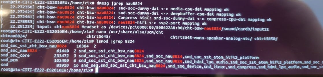

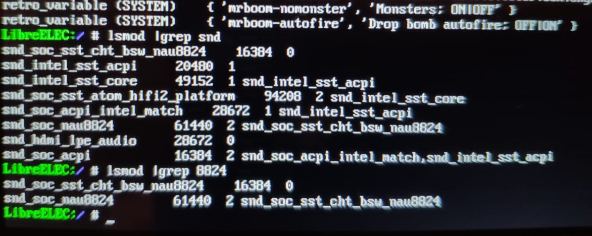

  • Good afternoon, I installed LibreELEC-Generic.x86_64-9.1.501 on the Charry Trail netbook Intel Atom X8350, everything works except for sound, aplay -l view and HDMI and chtnau8824, kodi sees it too, but the sound does not go through the code or from the console, ucm files are available, on ubuntu 19.04 the sound works immediately, through alsamixer I see the settings and sound levels, but there is no sound itself.There are some additional sound modules on ubuntu, but they are not in Libreelec. and I can not find them in linux.x86_64.conf
    What logs can I provide?

  • I found out that when loading the sound parameters did not apply or something was wrong, since
    Alsamixer does not show the necessary settings After command "alsaucm -c chtnau8824
    set _verb HiFi set _disdev Speaker" settings in alsamixer appeared, and the sound
    works.

  • I resoled problem by:
    systemctl stop kodi
    pactl load-module module-udev-detect
    systemctl start kodi
    Sound working perfect, but i see "pulseaudio default bluetooth" as default sound
    BUT
    sount via alsa in other apps not working.....need reboot =(
    How can i combine this drivers& =(
