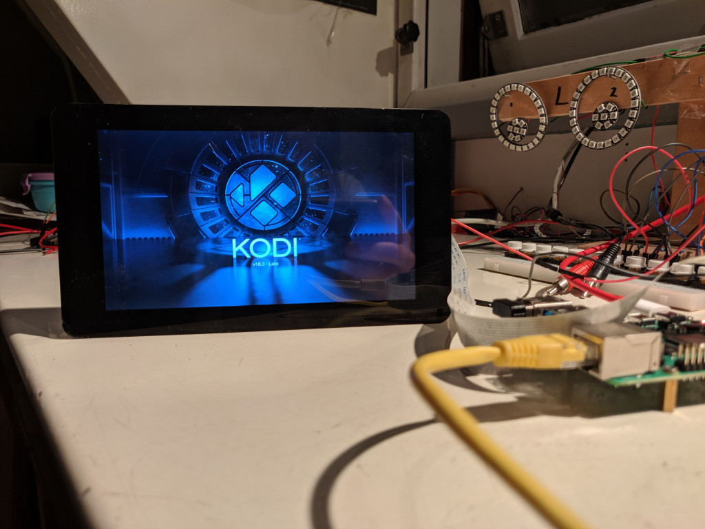

  • Hello fellas,
    recently receiver my RPi 4, clean flashed a image of Libreelec for the RPi 4, put it in my pi and hooked up power.
    First boot it was formatting and doing some stuff, then after reboot I got stock on the following splashscreen.
    I tried multiple different SD cards, Ethernet plugged in and out, removed my usb-receiver for my wireless keyboard, tried different power adapters (currently using the Oneplus 3 dash charger).
    I don't understand why it is stuck.
    As you can see I'm using the official 7'' Raspberry Pi touchscreen (works perfect with raspbian).
    somebody any idea ?
    other OSes like raspbian boots and functions perfectly fine.
    Thanks in advance,
    Cas

  • Same frozen splash for me.
    Kodi is running as I can access the chorus web interface through the 8080 port. UI is held up at splash screen.
    Can't enable ssh or access the system to check logs until a micro-hdmi arrives in the post.
