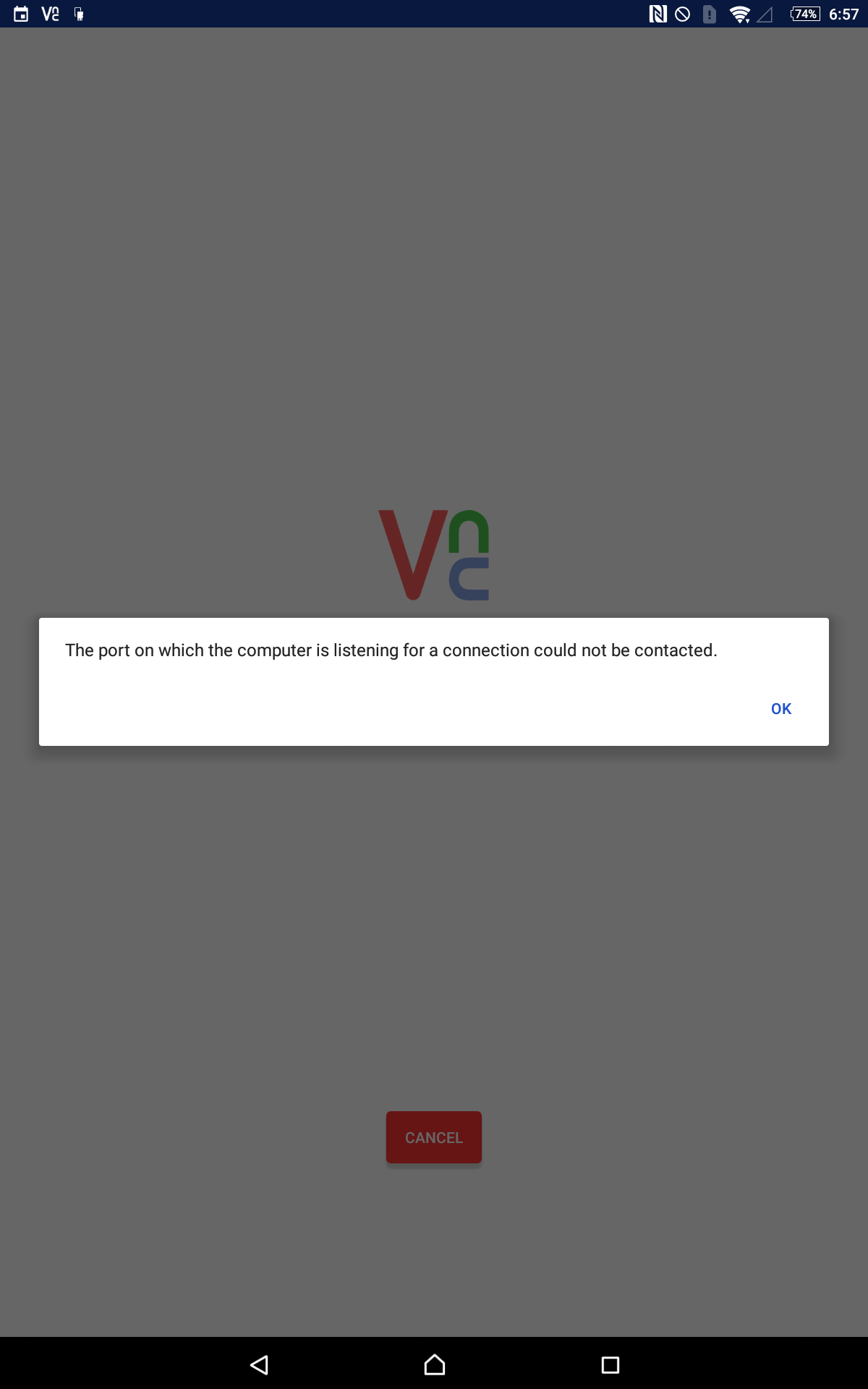

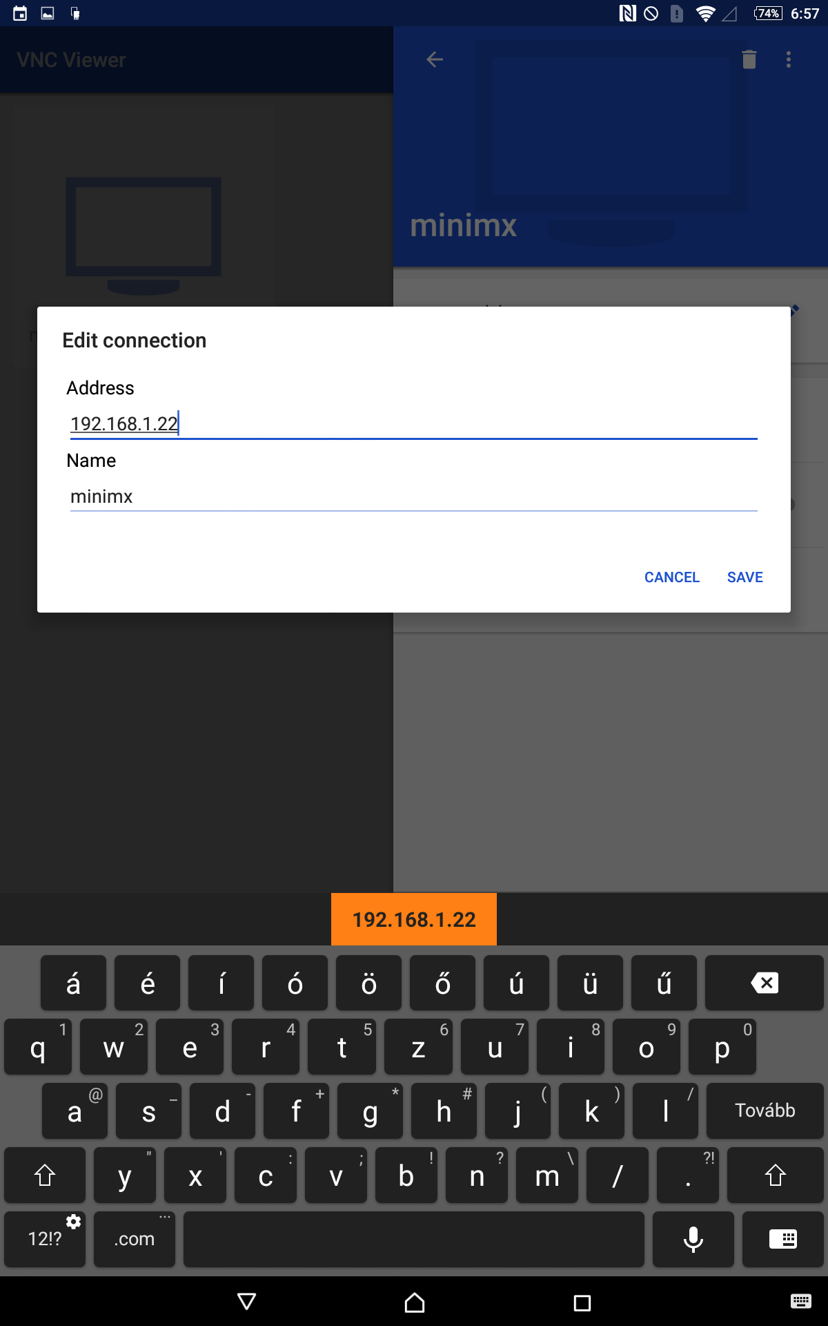

I download this:
service.system.aml-vnc-7.0.2.zip
After successfully install I cannot connect to my s905 device.
This addon compatible with s905 device?

This addon is not compatible with arm64. It's on my todo list to make it.
Thanks for fast answer ![]()
Please post there, when it will available.
envagyok Please try the new build: Release 7.0.3 for LibreELEC · kszaq/my-addons · GitHub
