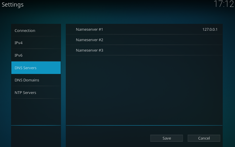

I would like to add 127.0.0.1 as a nameserver in my resolv.conf file but it gets overwritten every time I reboot. I'd also like to keep the other three nameservers it gets from DHCP as well.
Any help on what else I can try or look at to get this thing to resolve the name from the hosts file properly?
