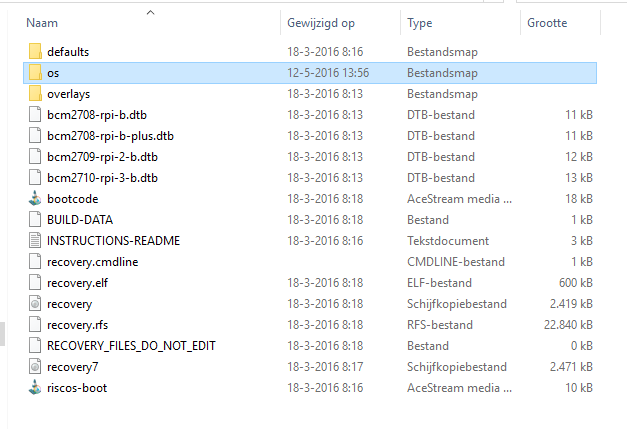

    Well, my raspberry pi came with a SD card that already contained some images. During the installation procedure, I chose to install LibreElec. The root of my SD card looks like: see attachment
  • Well, my raspberry pi came with a SD card that already contained some images. During the installation procedure, I chose to install LibreElec. The root of my SD card looks like: see attachment
    Yes, that is NOOBS. If you press shift when booting, you can stop in NOOBS configuration. That includes a menu option to edit config.txt.
