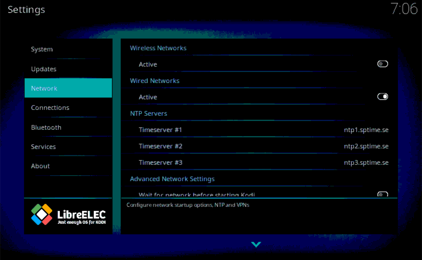

  • Log shows the ntp service works, but the mount attempt is some time before the clock is updated.
    Create /storage/.config/autostart.sh and add the command "date -s "06 FEB 2019 11:10:00" (make it to something close to current) and reboot. I'm wondering if negating the clock drift solves anything? Is there any difference when using the default (pool.ntp.org) servers?
