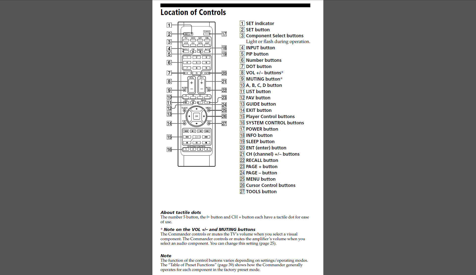

  • Hello,
    This is my contribution to LibreELEC users who have a Zotac mini-PC.
    So, I've been using this remote.xml keymap for my Zotac Nano AD10 for years now.
    And it is working perfectly for LE 8.2.5.
    When I updated to 9.0.0, I got lots of grief with my remote thinking "this is the reason I left OpenELEC for LibreELEC in the first place!".
    The remote COMPLETELY stopped working (whereas with OpenELEC 8.0.4, I was forced to press the same key TWICE, when the previous version worked flawlessly!).
    Anyways, now I know what to do (use Microsoft MCE codes with my Harmony, or try the new LE updates), but I wanted to thank the community for your help. So here's how I managed to program my remote with this remote.xml keymap.
    The 01- remote (06-2017 keymap from kodi website used as reference).xml one was downloaded from KODI and modified to work according to my own taste. The other two are based on this one. To use them, just rename them to remote.xml and copy it to the keymaps folder inside userdata.
    Have fun
    01- remote (06-2017 keymap from kodi website used as reference).zip
    02- remote (last used for sony RM-VL610 remote on 06-2017).zip
    03- remote (currently using for harmony remote since 10-2017).zip
