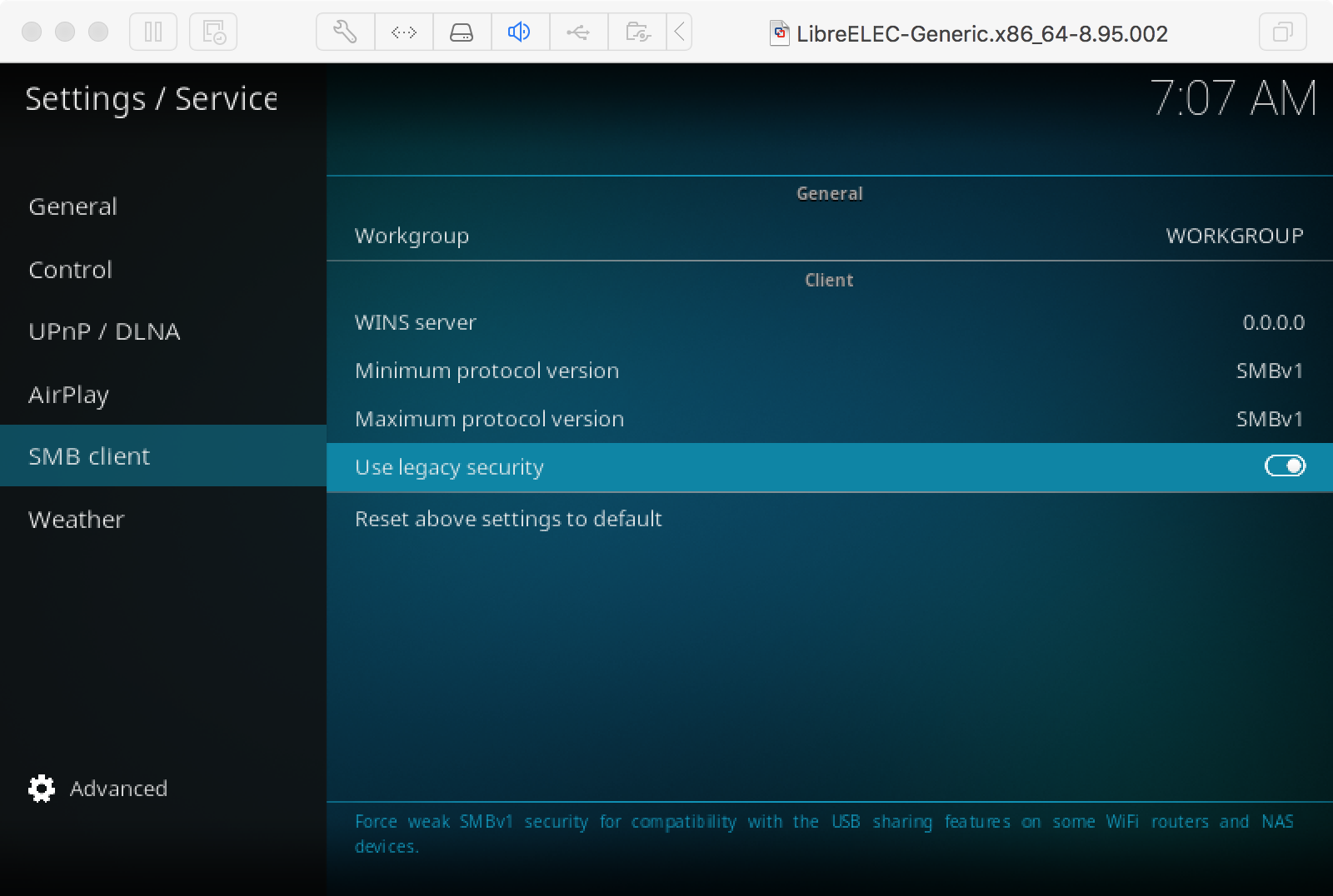

  • I have the same problem.
    But I can not find this legacy option. Can someone post a screenshot where to find it?
    Using a USB-disk connected to my fritzbox and try to reach it via smb from LibreELEC on my raspi 3

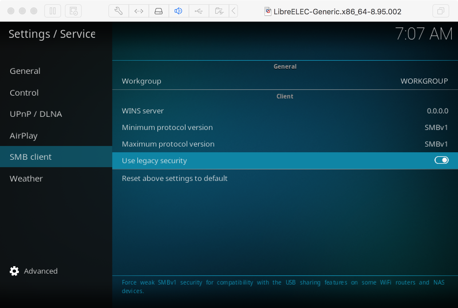

  • The legacy security option is visible when SMB1 is set for min/max. You need to configure this in Kodi SMB settings not the LE Samba settings (which are for Samba server, not client).
  • Settings > Service > SMB client .. screenshot below from the current 9.0 beta. You need to have Advanced or Export settings mode to see the SMB client options:
  • Ok, after enabling both mix, max settings to SMBv1 the option for Legacy security become available and I enabled it.
    Now all is working as before ! Thank you much Chewitt !
