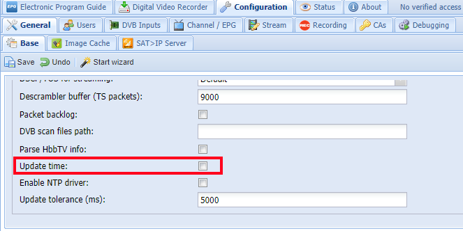

Looks like there are two options in Tvh - the Update time will work if you are root and is supposed to be more reliable, the NTP driver will run as any user but is less reliable?
QuoteTime Update
Tvheadend has a built-in capability to update the system time. However, you should bear in mind that DVB time is not highly accurate and is prone to both jitter and variation between different transponders.
Where possible, it’s probably still better to use an internet based NTP source to synchronise the system clock (i.e. through the underlying operating system).
Update time : Enable system time updates. This will only work if the user running Tvheadend has rights to update the system clock (normally only root).
Enable NTP driver : This will create an NTP driver (using shmem interface) that you can feed into ntpd. This can be run without root privileges, but generally the performance is not that great.
Update tolerance (milliseconds) : Only update the system clock (doesn’t affect NTP driver) if the delta between the system clock and DVB time is greater than this. This can help stop excessive oscillations on the system clock.
Tvh runs as root at LE, so it would work - like said never tried.

I already activated time Update function. But i saw no effect on Client.

Have you watched a channel since you enabled Time Update?

Yes, i watched other Channel.

If i set Update time in Backend, then the time at wetek should be ok? This point i didn't checked.

To make recordings properly, your backend time needs to be set (as it needs to know what time to start recording) In this case your Wetek.
To display a programme guide I would expect your front-end time needs to be correct, as it will need to know the client's time to display the 'right' section of the guide. (ISTR TV Headend can cope with a client and server in different time zones)
An RTC on the Pi is probably the easiest way of keeping the Pi time/date correct?
It could be DVB Time on the Wetek (either via TV Headend or dvbdate) and an RTC on the Pi is the approach you could take.

i think i must Check If the wetek Server is getting time with dvb Broadcast (Update function).Can i See it in Backend?

Can you ssh into the Wetek? I think typing
will return the system time and date.
