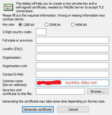

At the end it is very easy to make it work
As source use ftps://user:[email protected]:990/|auth=SSL/TLS
When creating certificate in FileZilla FTP server you ABSOLUTELY need to enter Common name (Server address) as shown on picture
Then you need to convert certificate from crt to pem format using openssl tool on LibreELEC box or somewhere else with command
and copied to users' cacert.pem
After that run openssl-config and restart kodi (systemctl restart kodi) or just reboot. And it should work like for me here.

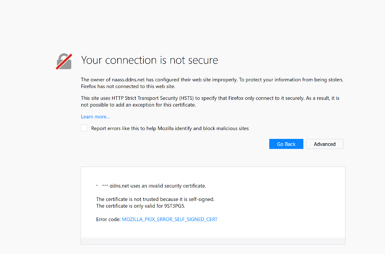

However I have no idea how would KODI/LE react for a source that has a self-signed certificate. Sadly you can not have a reliable SSL certificate for a dyndns server, or at least I was not able to read enough to accomplish just that. -
Without a problem I think? Just needs to provide ca's cert in /storage/.config/cacert.pem.
What is the issue with it?
It seems that without a properly working rev-DNS (and it does not work as intended in case of dyndns'ed computers) it's not possible to have a certificate (I tried Let's Encrypt) issued. I'd have to dig deeper into it since I believe it should but am just too dumb for that.
