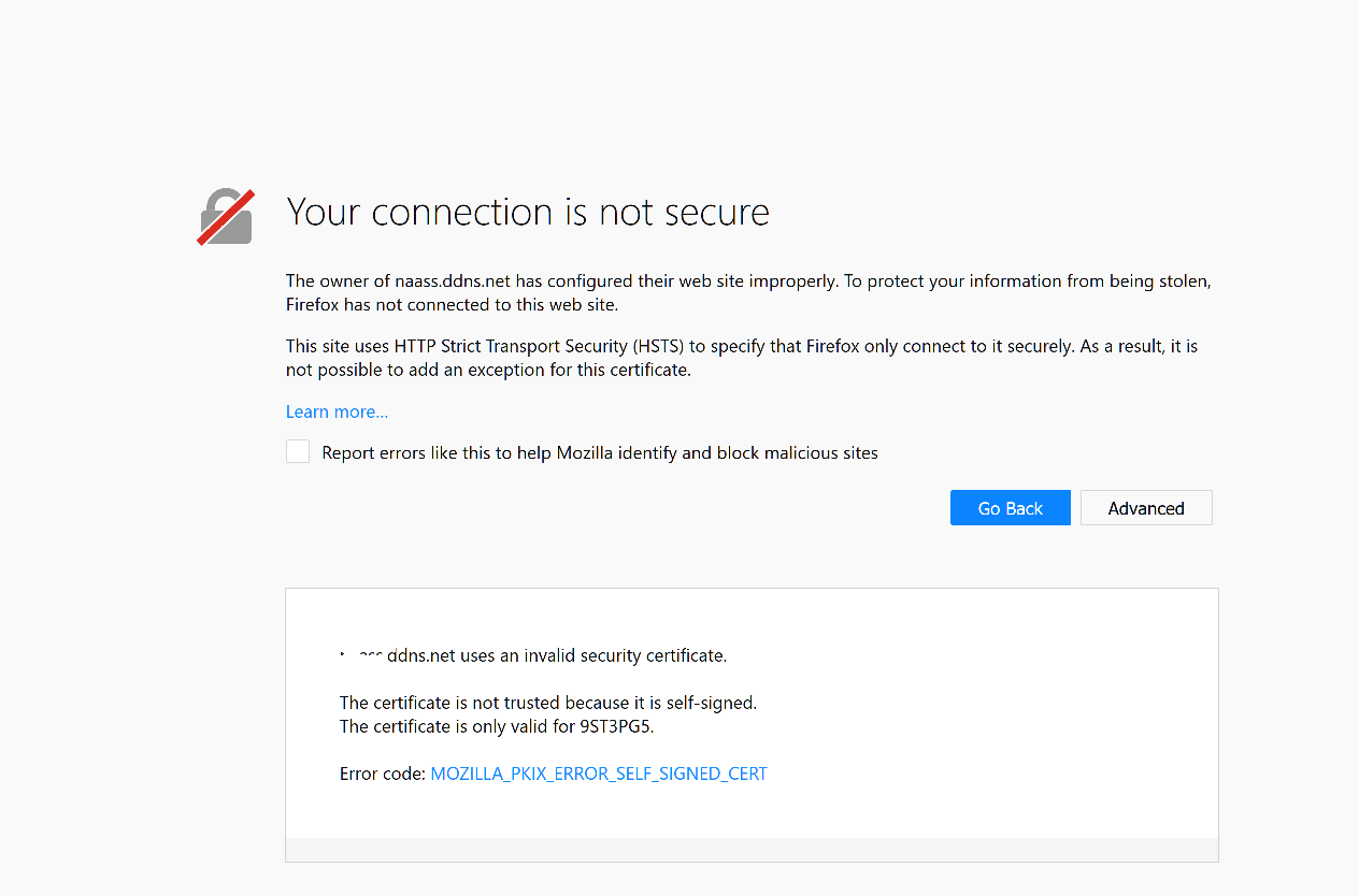

    On page you need to click Advanced, Add Exception and then Confirm Security Exception
    When I click on Advanced, I have no "Add Exception" button! as you can see on the attachment.

    I managed to setup a WebDAV using IIS 10 manager. But, I have difficulty to connect to the server. Using Firefox browser, I have an error saying that the site is untrusted due to self-signed certificate. I have no button to r choice on the page to tell Firefox to trust my site!
    I'll continue to fiddle out with Firefox connection and when I give up, I'll try xaamp/Apache.
