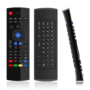

  • This problem continues with V9.0, running on a RPi3. It relates to the M3 2.4G Wireless Remote Control Keyboard Air Mouse, a picture of which is attached.
