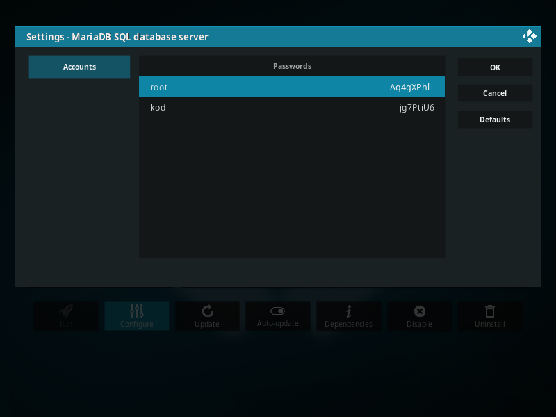

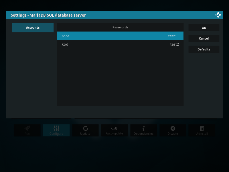

  • Hi vpeter,
    I reinstalled the addon and made a test with default passwords, I could access mariadb, then I changed the password in addon and I was unable to access again, so I reinstalled again the addon and tried to change the password from command line following some examples in internet, but password was not updated. Do you know how to change it?
    thanks

  • I don't understand what is happening in your case but as soon password is changed from addons settings and get back to home menu mysql server is restarted and password is changed:
    LibreELEC.tv/mariadb.start at master · LibreELEC/LibreELEC.tv · GitHub
    Anyway, password is set in file /storage/.kodi/userdata/addon_data/service.mariadb/settings.xml.
    Changing password directly from mysql could have some side effects (like changing it to something else after restart). I newer even tested such
    scenario.
  • Hi,
    it's like were55 saying if you alter the passwords via addon settings you cannot connect. I did the same but before i first tried i altered the passwords without success, after removing the addon and readding it without altering the passwords it worked.
    Regards X23
