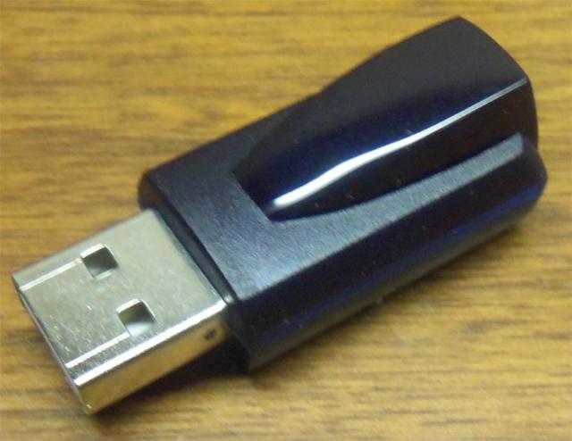

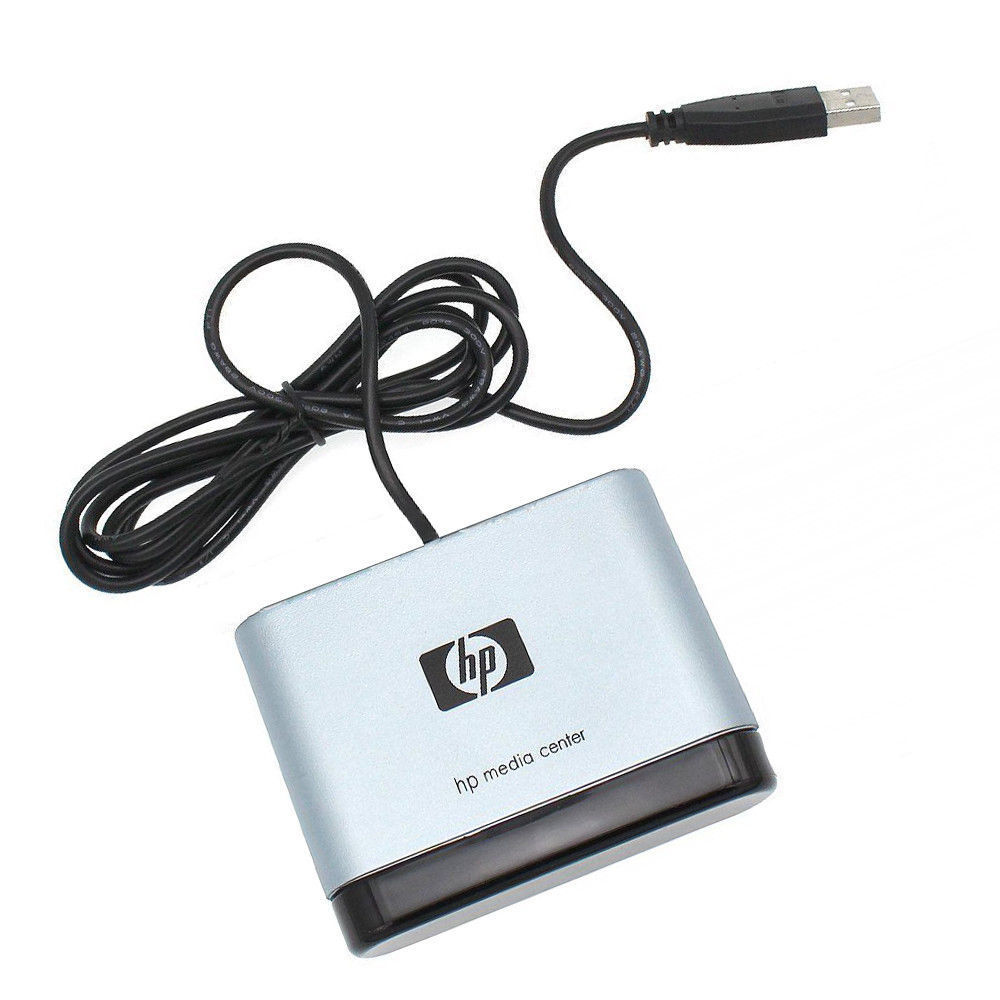

    Since my Intel NUC's are quite old (3rd gen), they don't contain an IR Receiver, so I was using the popular HP USB IR Receiver sold on ebay for around $10 new.
    I ordered a generic (much smaller) USB IR Receiver (model IR603) and use it instead of the HP receiver. I have turned my NUC on and off about a dozen times over the last few days and not once did I have a black screen. The other benefit of this cheap generic IR receiver is the sensitivity. It's FAR better than the HP. I can point my Harmony 650 in almost any direction and don't have to aim it like I was before. Here are pictures of the two IR Receivers
