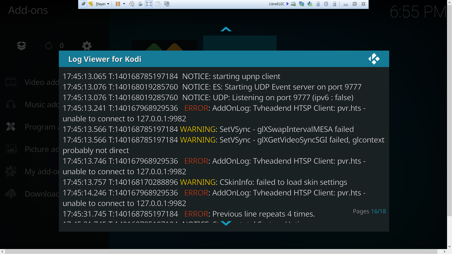

    I am getting an error installing TVHeadEnd on my LibreElec Kodi install, which is part of a VMWare Player mount. I am getting an error that it cannot connect to 127.0.0.1:9982. This is not the IP address given for my install in Kodi however. I am not sure what to do in order to correct the problem. I do not have the option to configure the install before installing it in Kodi. Can anyone tell me what I am doing wrong?

  • You installed the TVH client (pvr.hts) and it cannot connect to the local host (127.0.0.1). Did you install the TVH server addon?

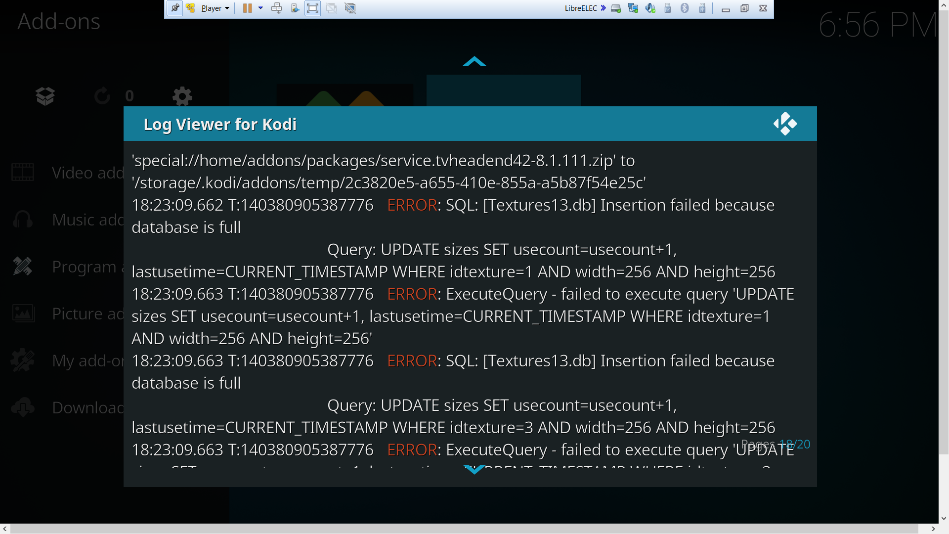

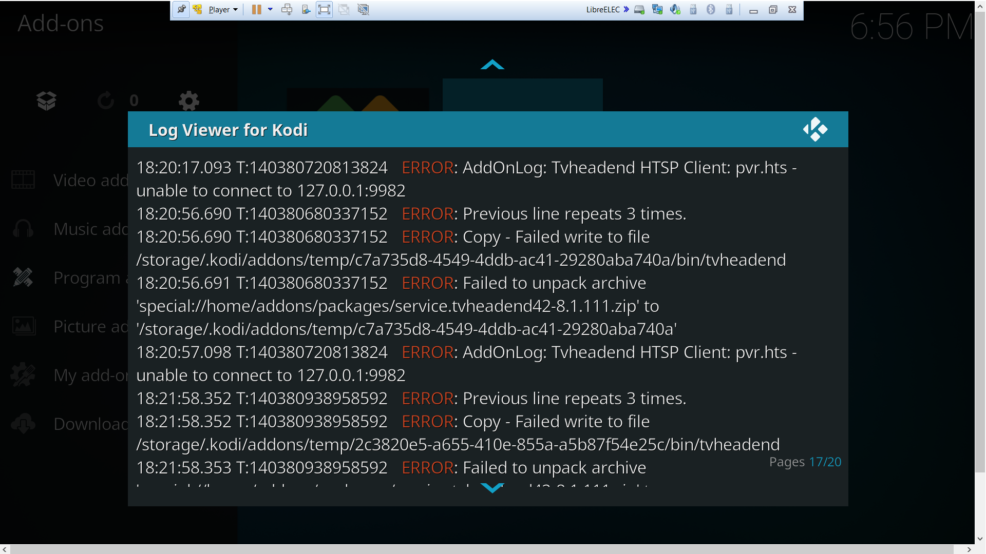

  • The pvr.hts "failure to connect" warning is normal when there is no local tvheadend sever and you didn't configure the client to point to a server yet, but everything else half-visible in the screenshots just looks like a screwed up install; and considering it's an untested/unsupported platform that doesn't surprise me. There's a load of OpenGL related warnings .. maybe more. If you want a cheap HTPC device go purchase a Raspberry Pi for $30 and do things properly (seriously..)
