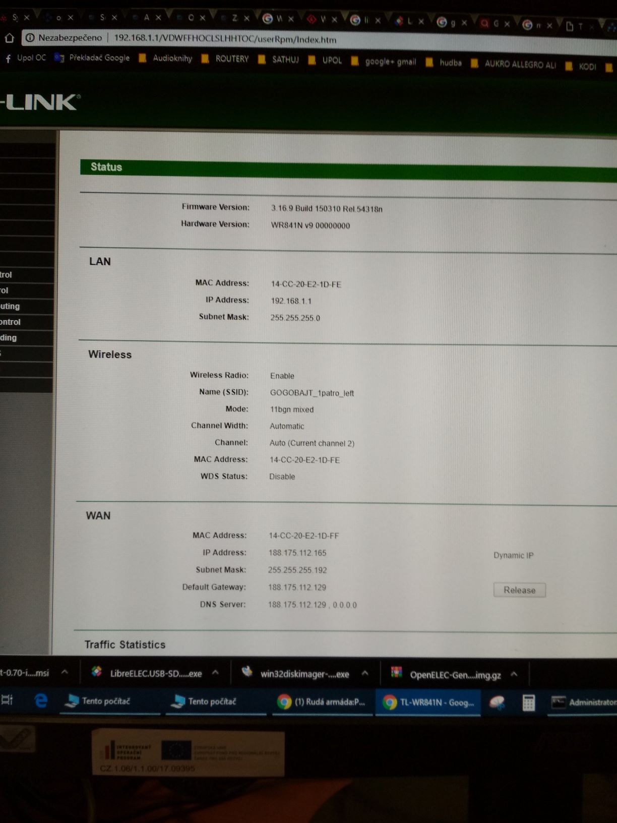

  • Yes. New settings lan kodi static ip
    setting static ip address on kodi was accepted info system network kodi = no conected
    Test 1:
    ip KODI 192.168.1.88
    Geatway 192.168.1.1
    DNS 192.168.1.1
    MASK 255.255.255.0
    standard settings
    I also have the default settings on other computers
    No conected
    Test 2: (absurdly)
    GEATWAY 188.175.112.129
    DNS 188.175.112.129
    Mask 255.255.255.0 or 255.255.255.192
    No conected

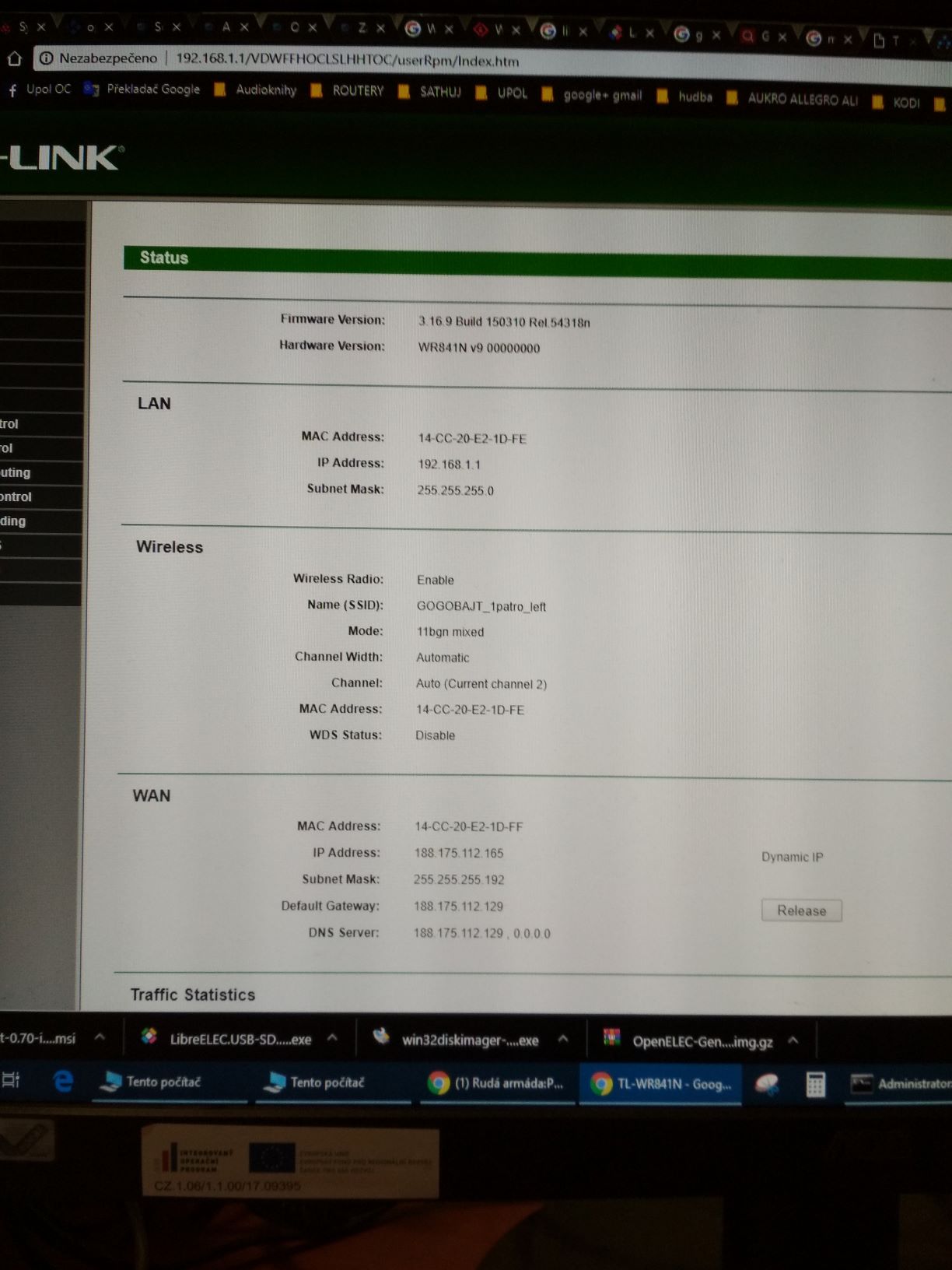

    Router is
    TP-LINK TL-WR841N (192.168.1.1/254 or DHCP 192.168.100/199)
    Switch is
    TP-LINK TL-SF1005D
    more information
    Test 3:
    Auto DHCP the router does not give the IP adress for KODI. Mac adress KODI is not visible in DHCP client list on router.
    Settings Static IP adress test 1,2 it is no connected
    Test 3 no conected.
    after every change ip address i do restart and control systém info settings network on kodi.

  • The 2nd test has a switch. Try a direct connection from the box/pc to the router.
    & or try different network cables.
    I have this
    under ipv4 I have ip address method: manual
    ipaddress 192.168.1.115
    subnet 255.255.255.0
    default gateway 192.168.1.254
    under DNS servers I have Nameserver #1 192.168.1.254
    I don't know much about routers, perhaps you could add the kodi box mac address manually

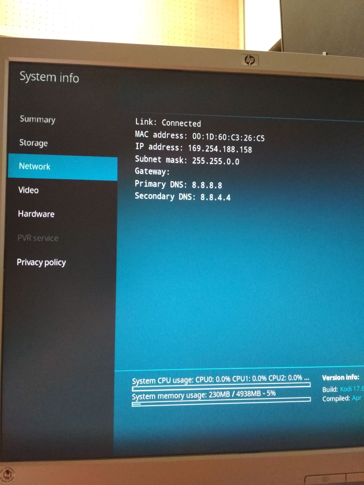

  • This default ip
    169.254.144.237
    255.255.0.0
    And dns Google 8.8.8.8 , 8.8.4.4
    IT Is absurd.
    this setting is original, but it does not work.
    i mean switch tp link is a problem (169.254.144.237
    255.255.0.0)
  • I can only suggest you google for an answer to ip addresses beginning with 169.
    How to fix a 169 IP address so you can get online - Quora
