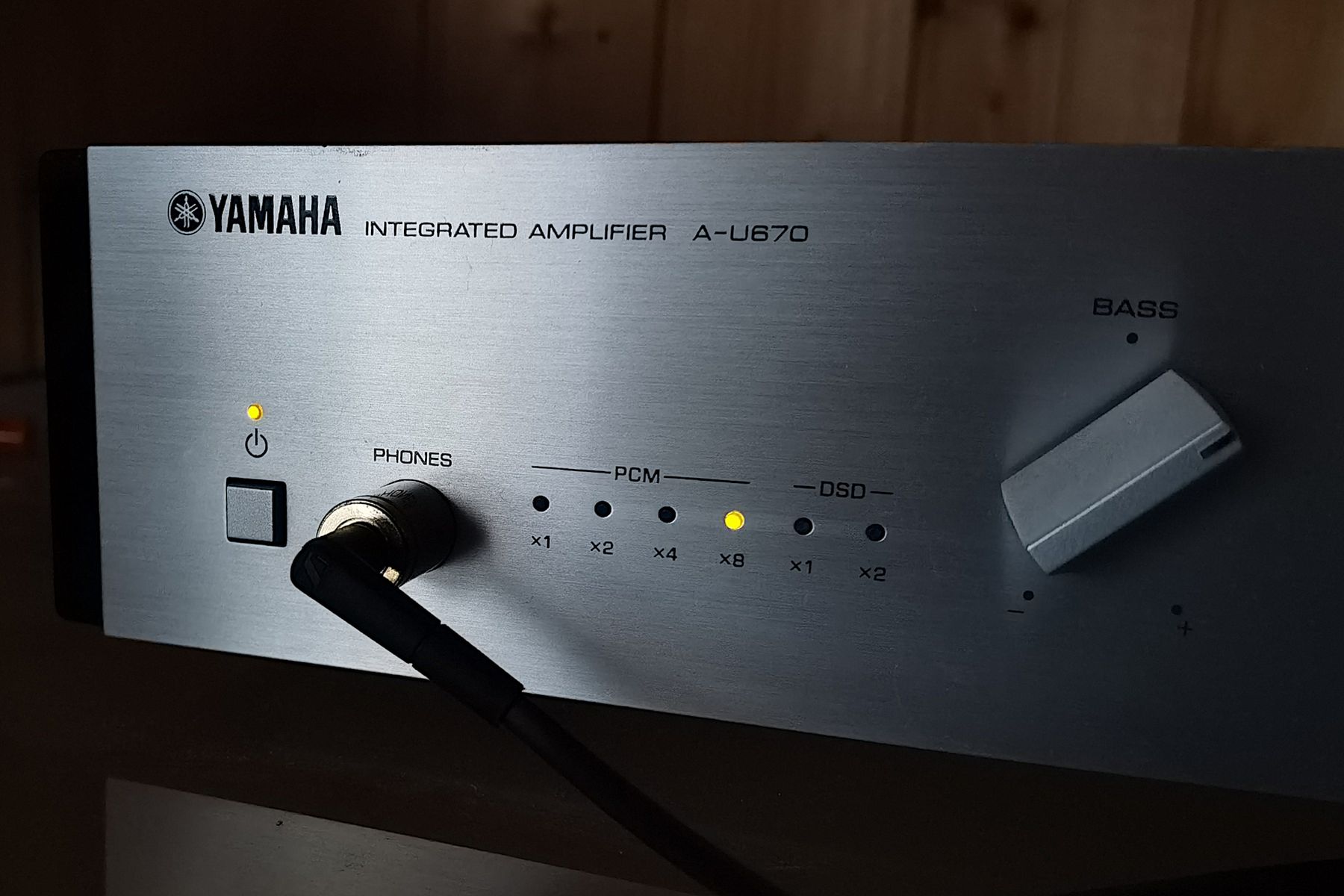

    Since my DSD Files are converted to 44.1kHz PCM, I have to asume, that my YAMAHA Amplifier is not registered in that list by his USB ID.
    Is there any easy way to provide LibreElec with the YAMAHA USB ID without the need to compile the whole distribution?

    What Yamaha amplifier do you have ?
    I take it from your post that it has a USB connector that will appear to connected devices as a USB DAC for both PCM and DSD audio? If you find out the USB IDs for it that may help?
