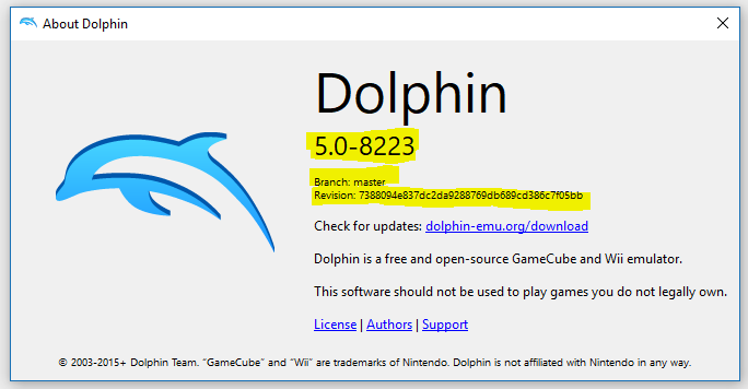

  • Well it always bothered me that Dolphins "about dialogue" was screwed up and showed utterly garbage. It uses a script to gather some system & git version information that were displayed later in this window:
    The windows build you can download shows the right format so the release 5.0-8223 / branch master / revision git commit.
    Below you see what Dolphin lists in my linux build:

    But it should look like this:
    Code: scmrev.h - correct
    #define SCM_REV_STR "7388094e837dc2da9288769db689cd386c7f05bb"
    #define SCM_DESC_STR "5.0-8223"
    #define SCM_BRANCH_STR "Master"
    #define SCM_IS_MASTER 0
    #define SCM_DISTRIBUTOR_STR "None"
    #define SCM_UPDATE_TRACK_STR ""
