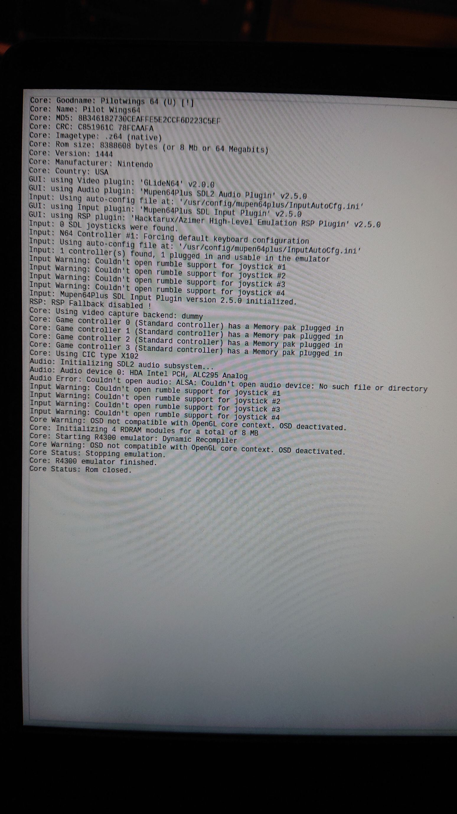

5schatten I finaly tried your build of standalone mupen64plus, it seems to work fine but there is no sound on both my desktop and laptop, here is a screenshot of my laptop (asus ux430 with intel 7200u)
You have to set the correct audio device in asound.conf -> I've added a basic autoconf function in builds past Beta15 that takes over kodis settings but does not work in every case. So open the file advanced.conf in rr-config and set the autoconfig to false.
Then you have to edit the asound.conf by hand and enter the correct device as written in the FAQ.
What is your aplay -L output and what is the content of asound.conf?

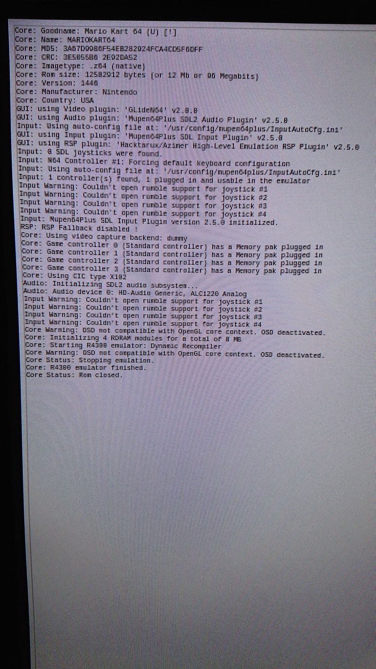

5schatten Tried today on my desktop, It seems m64p standalone is not picking the correct audio out.
Kodi, Emulation Station and RA have working audio, asound.conf was correctly set automaticaly, but m64p is still using wrong audio out (analog instead of hdmi1) as you can see in my screenshot and errors in m64p.log
Well as I said I need the content of you asound.conf & the output of aplay -L
There is no special m64p specific sound configuration as it uses the SDL audio backend the same way as every other SDL based frontend or emulator. LibreELEC.tv/mupen64plus.start at libreelec-9.0-rr · 5schatten/LibreELEC.tv · GitHub

Display MoreLibreELEC (5schatten): RR-201847-4b686db (Generic.x86_64) LibreELECPC:~ # aplay -L null Discard all samples (playback) or generate zero samples (capture) hdmi:CARD=NVidia,DEV=0 HDA NVidia, HDMI 0 HDMI Audio Output hdmi:CARD=NVidia,DEV=1 HDA NVidia, HDMI 1 HDMI Audio Output hdmi:CARD=NVidia,DEV=2 HDA NVidia, HDMI 2 HDMI Audio Output hdmi:CARD=NVidia,DEV=3 HDA NVidia, HDMI 3 HDMI Audio Output sysdefault:CARD=Generic HD-Audio Generic, ALC1220 Analog Default Audio Device front:CARD=Generic,DEV=0 HD-Audio Generic, ALC1220 Analog Front speakers surround21:CARD=Generic,DEV=0 HD-Audio Generic, ALC1220 Analog 2.1 Surround output to Front and Subwoofer speakers surround40:CARD=Generic,DEV=0 HD-Audio Generic, ALC1220 Analog 4.0 Surround output to Front and Rear speakers surround41:CARD=Generic,DEV=0 HD-Audio Generic, ALC1220 Analog 4.1 Surround output to Front, Rear and Subwoofer speakers surround50:CARD=Generic,DEV=0 HD-Audio Generic, ALC1220 Analog 5.0 Surround output to Front, Center and Rear speakers surround51:CARD=Generic,DEV=0 HD-Audio Generic, ALC1220 Analog 5.1 Surround output to Front, Center, Rear and Subwoofer speakers surround71:CARD=Generic,DEV=0 HD-Audio Generic, ALC1220 Analog 7.1 Surround output to Front, Center, Side, Rear and Woofer speakers iec958:CARD=Generic,DEV=0 HD-Audio Generic, ALC1220 Digital IEC958 (S/PDIF) Digital Audio Output
So your second HDMI output [ hdmi:CARD=NVidia,DEV=1 ] is your desired audio output?
yes
Well to be honest I'm running out of ideas
The whole concept is that asound.conf sets the output for ALSA so SDL can hook up and the game can use the API for sound output. You can try to change ALSA to PulseAudio in the advanced.conf maybe this helps. SDL is then set to PulseAudio driver and PA detects sound outputs everytime it's launched.
