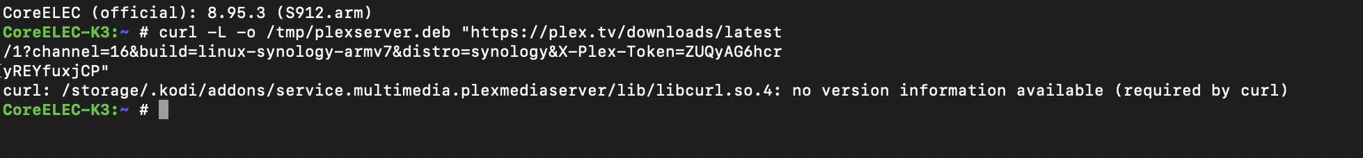

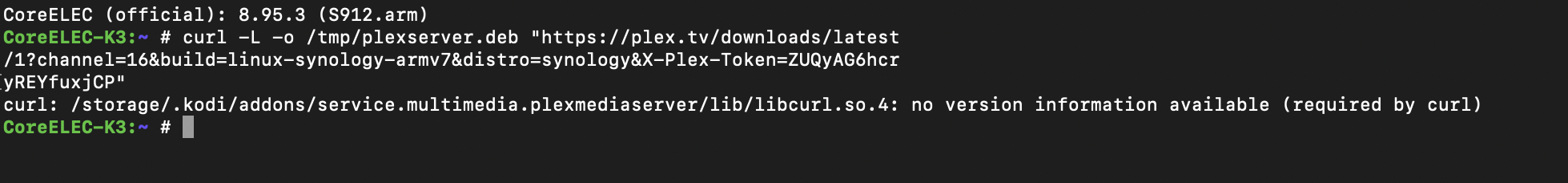

  • So the question now is, how do I update it? In setting, it says there is an update and then it says: install manually please. And it's a clickable link. If I click on that, my browser downloads this file: PlexMediaServer-1.13.8.5395-10d48da0d-arm7.spk
    I found this link where is a list of commands for updating manually through SSH. Will give it a go and see if it worked.
    Upgrade Plex Media Server with PlexPass on LibreElec via Command Line | naschenweng.info

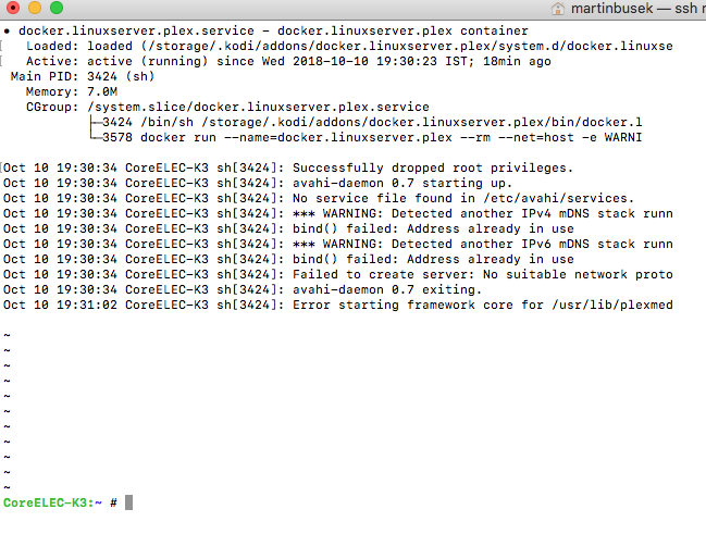

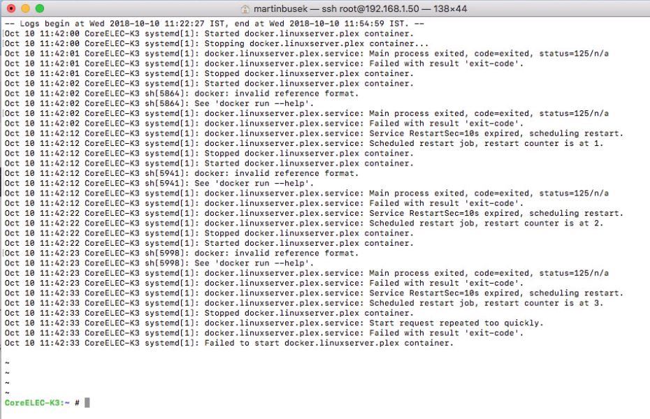

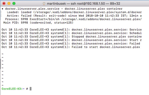

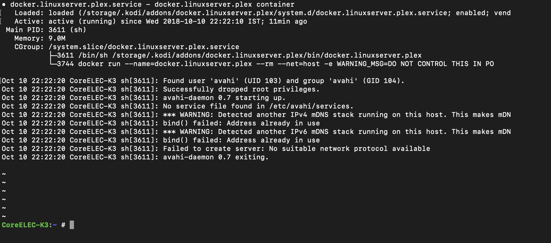

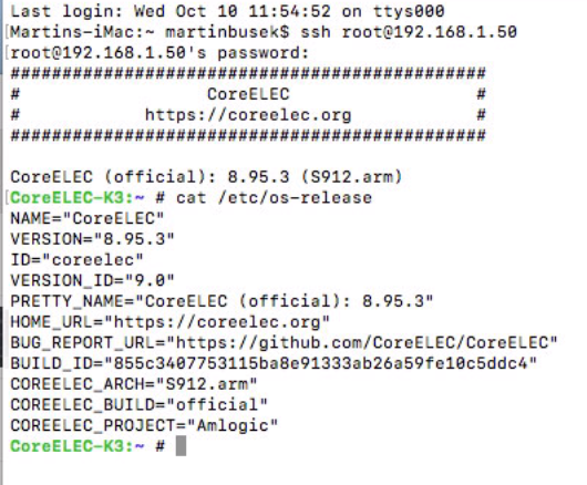

    I have tried everything. So again, if I install older PMS 1.0.4, it's working but needs to be updated but the update package is in .spk package instead of .deb, which I think is required.
    Anyway, I disabled this older Plex and installed the latest version from linuxserver addon. I enable the PMS, but can't login into it through the web. I'm attaching my log if it helps. Thanks for any advice.
