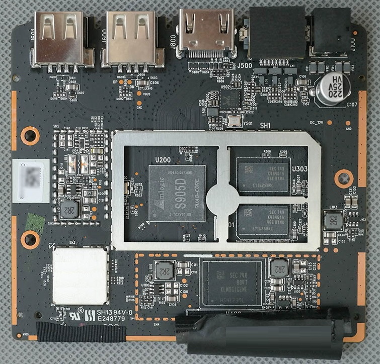

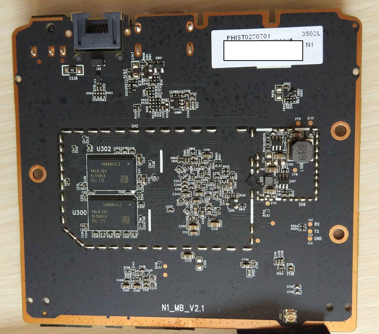

    I really have no clue now. Maybe I need to find the reset button? I attached the photo of circuit board here as well. Cant tell where the reset button is. :(
    Would you please give me some hints? Thanks.
    Front:
    Back:
  • Have you tried any 1GB dtb? Some manufacturer faking RAM amount...
    On the last picture you can see RX, TX, GND pads, you can solder a connector and watch debug info on it.

    Yeah, I tried 1G dtb. Unfortunately, same thing. There are not many selection for S905D device tree though.
    The RX, TX, GND pads look like TTL interface for me. I don't have much TTL experience on that either. :(
    I guess I need a USB-TTL line, and maybe software putty on my laptop?
    If I run adb reboot update like what I did above, do you know if it supposedly to run LibreELEC? or do I have to use reset button?
  • Can you look for the reset button / switch in the AV or SPDIF port? Some boxes had this weird implementation. Do you have such thing on the board?
    Try even in the power port, who knows? And this could be a solution: Reboot to LibreElec
